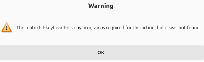

Most probably completely unrelated, but at my end with the recent update
I now get this
If I post here it is only because it is ‘keyboard’ related. Result is that I cannot see the keyboard layout for the 3 languages that I make use of.
W
I can add to this conversation. After this mornings update the keyboard layout switcher applet has been added to the panel (as part of indicator applet complete) when it was never there before.And if I click on it and select show current layout I get the same warning as @Watford .

Installing matekbd-keyboard-display fixes that issue.

This way ?
sudo apt-get install --reinstall libmatekbd-common libmatekbd4 mate-control-center
sudo apt install matekbd-keyboard-display
Or you can install using Synaptic.
