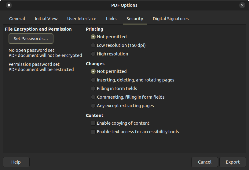

Attempts to export as PDF, with a password to prevent text copying or printing, appears to have no effect!
Does anyone else have this problem?
I can send the 5-page *.odt file to anyone who wants to test the actual file I experienced the issue with.

  • As soon as a PDF can be read by a PDF viewer, the document text is available to the viewer. Nothing enforces that viewer to read/interpret/respect do not copy flag. It is up to the viewer to allow copying text to clipboard or not.

many PDF readers do not implement copy permission because it's a silly feature to begin with - you can just use a PDF reader that doesn't implement copy permissions to work around the copy permissions... AFAIK no open source PDF reader - Evince, Okular etc. implements this feature. if it works with Adobe Acrobat, then we can assume that the passwords were written correctly into the PDF file by LibreOffice, and there is no bug. setting to NEEDINFO; please set this bug to NEW if you can reproduce this problem with Adobe Acrobat, or resolve it as NOTOURBUG if nobody can do that.

As for initial report, it's is NotABug. Because LO exports properly setting restrictions, can be seen with other PDF readers: Adobe, X-change, Master PDF. I don't have Acrobat but I see that it's similar for some other programs that can make PDF restricted content. Just some don't obey that, here is reported Okular, I confirm for Xreader. This bug should be reported to them. As for comment 2, that's a different issue, which is actually not a bug, because PDF security is not to be trusted to.
