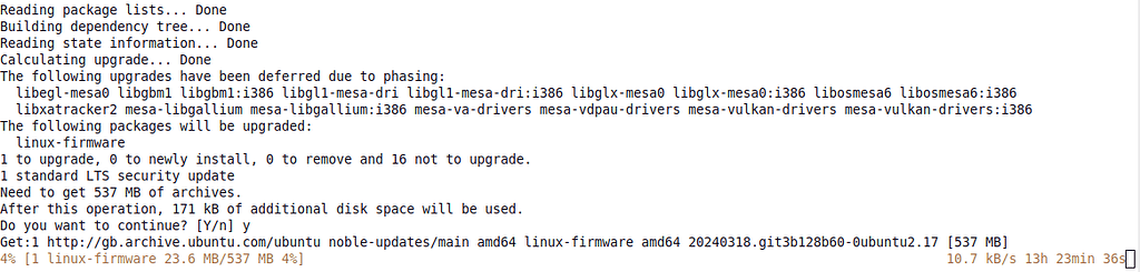

Hmmm. Usually this kind of thing passes after a bit, so I'm not overly concerned, but I'm curious as to the cause. I received notice that a linux-firmware update was available, but when I attempt to obtain it via
sudo apt-get -y install linux-firmware
I get
Err:1 http://security.ubuntu.com/ubuntu jammy-updates/main amd64 linux-firmware all 20220329.git681281e4-0ubuntu3.39 500 Internal Server Error [IP: 2620:2d:4002:1::103 80] E: Failed to fetch http://security.ubuntu.com/ubuntu/pool/main/l/linux-firmware/linux-firmware_20220329.git681281e4-0ubuntu3.39_all.deb 500 Internal Server Error [IP: 2620:2d:4002:1::103 80] E: Unable to fetch some archives, maybe run apt-get update or try with --fix-missing?
The apt update does not fix anything, and the --fix-missing appears to not exist.

Well, a 500 error is a server error (as even specified in the message), which is why I'm not overly concerned. Someone will likely get notified, look into it, make a fix, and then things will flow smoothly again. In the mean time, we wait.

Indeed, at the time that I'm writing this (5th September 2025, at 22H12) if I go to http://security.ubuntu.com/ubuntu/pool/main/l/ I get the expected directory listing BUT if I go to http://security.ubuntu.com/ubuntu/pool/main/l/linux-firmware/ instead, then I also do get the "500 Internal Server Error" that you've mentioned.
I've found that this error is being discussed in the "Ubuntu Discourse" in the following discussion topic:
The following reply in that topic, written by Thomas Ward (teward), that is an Ubuntu Technical Board Member, confirms the Incident and mentions that it's being solved:
And the following reply is from a person that specifically mentions that they're still having issues trying to update the "linux-firmware" package:
And Thomas Ward replied to it, saying that the only thing we can do now is to wait:

I was able to install the remaining updates, with the exception of linux-firmware, using the Synaptic Package manager. I’m glad I saw that recommendation for a replacement for the Software Boutique as … well … a Snap update replaced the “App Center” with the “Snap Store” which does not work (stuck on loading packages). But, that is a topic for another day / discussion.

It finally updated for me after a couple of tries but it took about 45 minutes and I had to change the server.
It's still balking for me. I would think the maintainers would remove the update notice until they've resolved the internal server error. So, I still get the notification, but nothing is available. @jymm, you said you changed the server. To what?

I had changed it to fastest after the first couple of tries when it didn't go, I changed it back to Server for the US and it didn't kick me out and finished and I know that because I ran it again but the update had tanen a long time. I had put it on a second desktop after about twenty minutes and went on with other things.
On my second installation it gave me packages had been held back when it finished. But they were not the firmware packages.
