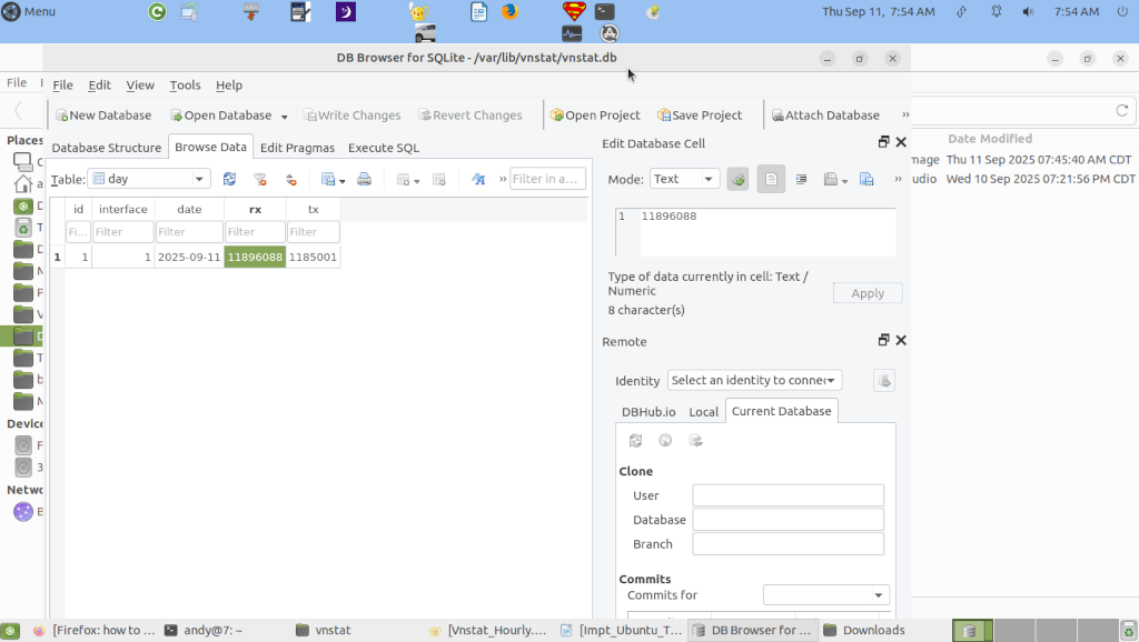

I would like to find out where I can find the log of download speeds in the
vnstat.db.
The SQLite "database" is located at
/var/lib/vnstat/vnstat.db
Unless you can manipulate that format, you will need to tweak the configuration for vnstat.

There is no /var/log/vnstat/vnstat.log.
It looks like vnstat is running.
Sep 11 15:28:04 7 vnstatd[35696]: Info: vnStat daemon 2.9 started. (pid:35696 uid:127 gid:137 64-bit)
Sep 11 15:28:04 7 vnstatd[35696]: Info: Monitoring (1): enp1s0 (1000 Mbit)
enable / disable logging (0 = disabled, 1 = logfile, 2 = syslog)
UseLogging 1
create dirs if needed (1 = enabled, 0 = disabled)
CreateDirs 1
update ownership of files if needed (1 = enabled, 0 = disabled)
UpdateFileOwner 1
file used for logging if UseLogging is set to 1
;LogFile "/var/log/vnstat/vnstat.log"

You almost got it there, Andy! Hang in there!
You forgot to remove the semi-colon in front of the LogFile parameter.
