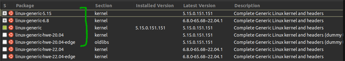

Also, if I understand correctly, in a single Synaptic operation, I should check to have removed the grouping highlighted with green AND select only one (or both) of the remaining two for full install?

They arent exactly exclusive; otherwise APT would know about the conflict. But in most situations there is no reason to have both.
I only found out about HWE (hardware enablement) when the GA (general availability) kernel had a regression. The GA kernel is basically the kernel that the Ubuntu release started on (i.e. 6.8 for 24.04). The HWE is intended for supporting newer hardware because the Linux kernel is monolithic (i.e. drivers run in kernel space) and as a result most device drivers ship with the kernel (obvious exception being drivers supplied via DKMS; which includes NVIDIA drivers).
So! How to choose linux-generic versus linux-generic-hwe? In my experience; simply because I had to due to a regression; that was on either 20.04 or 22.04 (cant remember).
Lately, on 24.04, I'm happily running 6.8 (GA) but I have also installed 6.14 (HWE) as an experiment - I noticed no difference.
For noble or 24.04 the package is linux-generic-hwe-24.04 (not linux-generic-hwe), though I wonder if you assumed that would be understood.
Most of my LTS releases have both kernel stacks installed, so I can select at grub which I’ll use. By having both metapackages installed both will get updated (three stacks too if you include an OEM kernel). Some closed source kernel modules (eg. some nVIDIA) can prevent multiple stacks from co-existing; but that is a package restriction that only applies due to some closed-source packages.
