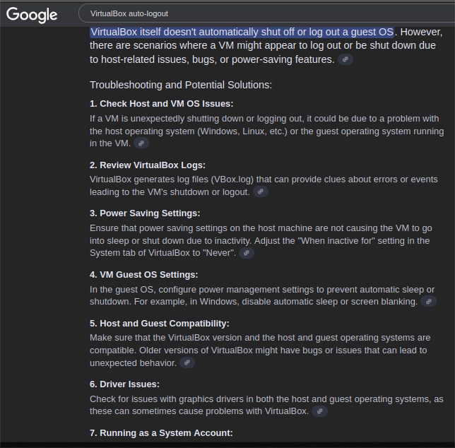

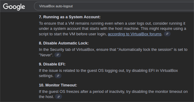

@ericmarceau
Thanks for the reply. I had another look at the images (not a link) you posted. Unfortunately those ideas are for when a single guest VM exits.
My issue is that either
(1) the host Ubuntu MATE logs out the currently logged in user, which exits all applications including all guest VMs or
(2) the entire host Ubuntu MATE reboots all the way to the black screen where I could enter the BIOS.
If you have any ideas for my use case, please do let me know.
Thanks!!
