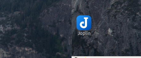

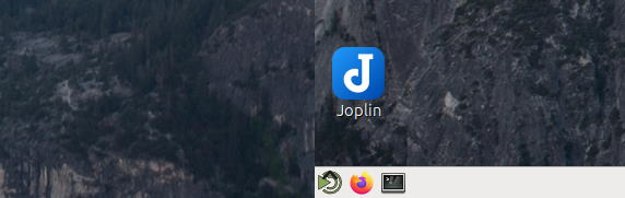

Here are two screenshots, the first demonstrating the problem and the second how it should look. Because I have a dual monitor setup, the screenshot includes both monitors. I cut the screenshots down in size to save space, so I'm only including a small portion where the displays meet.
I display the panel on the right screen, which sits directly in front of me, while the left screen is off to the side.
I appreciate any ideas. I tried different resolutions, but they all exhibited the problem.
