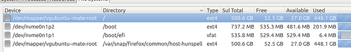

While the real issue I was raising here is not really the swap use (which I underlined), but this " /var/snap/firefox/common/host-hunspell " which seems to grab/eat so much of the memory and basically by same size then the actual "/"....
Just need to understand what for. What is the problem it creates. It would be weird to end up with no mem left on a 1T laptop....

I see. Surely,
is an overkill and actually guarantees no effect for the host-hunspell is for spelling dictionary. More information is here: [SOLVED] Why is Firefox 'host-hunspell' being loaded at boot?

So in layman's term it means that what it shows as a memory grab ends up only a 'ghost' created by an access to system files. Kind of misleading....
How is such an access to system files limited ?
You are correct in that bind mount of "/var/snap/firefox/common/host-hunspell" refers to the existing space which is shown/counted twice due to the trick.
As far as I know, 'snaps' have been intentionally limited in their access to the rest of the system due to security considerations.

Result of df -ht /
as of now....

Thanks for the output :slight_smile: If you wish, you may run the following command which will list the 25 largest directories of the / filesystem (without descending to other filesystems) and their respective sizes. That may help you identifying the culprit:
sudo du -h --one-file-system / | sort -rh | head -n 25
This does not look like a 1TB setup at all.
You have separate partitions for /boot, /boot/efi and a large 500GB LUKS container for your root filesystem. And it is almost full.

Hi again, @Watford
Thanks for the output :slight_smile: I have the following comments:
1 - I agree with @ironfoot regarding the reply he gave you above - "Memory and disk usage UM 24.04 - #17 by ironfoot" : it seems that the NVMe SSD - nvme0n1 - where you have installed your Ubuntu MATE 24.04 LTS ("Noble Numbat") is about 500 GB (476.9G) in size and not 1 TB, as you can see in the first line of the beginning of the "lsblk" output that you included in your original post in this topic:
2 - Your / filesystem is 416 GB in size. The /home directory seems to be part of that / filesystem and not a separate filesystem (both options are perfectly reasonable, in my opinion).
3 - Your /home/user directory is occupying 384 GB:
384G /home/user
4 - Of those 384 GB, the following "Mozilla Thunderbird" user profile seems to be taking about 188 GB in size:
188G /home/user/snap/thunderbird/common/.thunderbird/88360zp9.default-release
5 - I'm guessing that the majority of the remaining space is being taken by your /home/user/pCloudDrive but I can't say for sure given that I'm unfamiliar with "pCloud" and also because of the following "Permission denied" lines which hide the space that it's occupying:
root@user:/home/user# du -h --one-file-system / | sort -rh | head -n 25
du: cannot access '/home/user/pCloudDrive': Permission denied
du: cannot access '/tmp/.mount_pcloudJOBV5w': Permission denied
Even worse: it looks like this massive user profile was duplicated during the .deb-->.snap upgrade, compare:
/home/user/.thunderbird/
and
directories.
