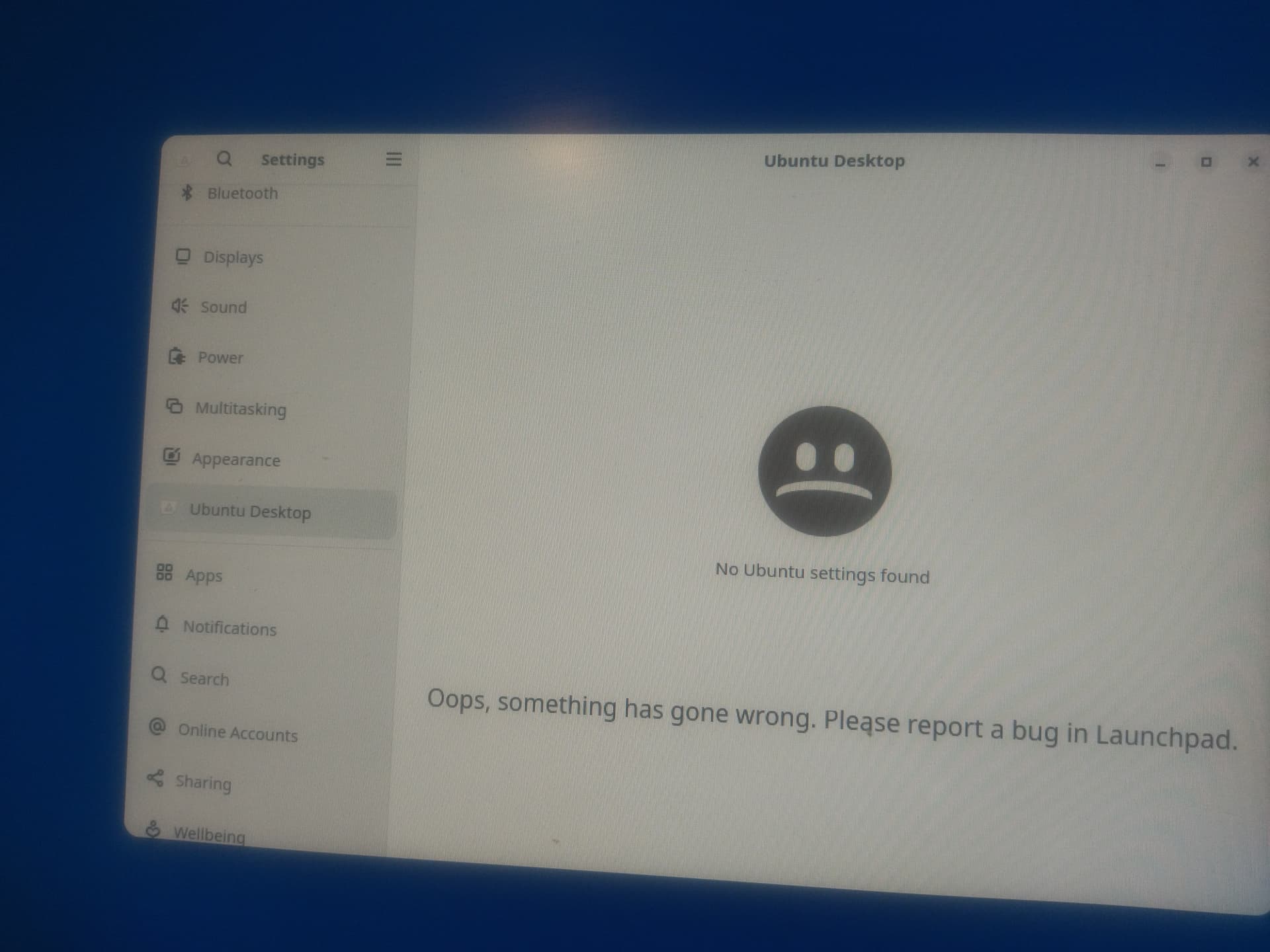

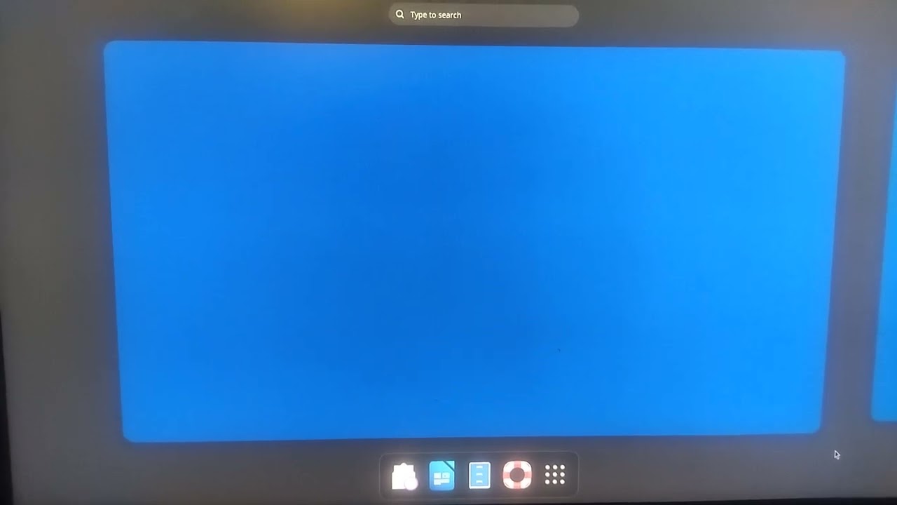

My Ubuntu Mate 25.04 restarted in a totally different appearance
How can i revert to default?
Thanks!
Seems to be something wrong with Ubuntu Desktop
Yes indeed, there is something wrong with ubuntu-desktop, it is called GNOME
Why did you install it in the first place if you don't like it ?
To correct this error, open a terminal and invoke the incantation:
sudo apt purge gnome-shell*  ubuntu-desktop*
sudo apt install --reinstall ubuntu-mate-desktop
If that doesn't work: wipe and reinstall
and don't try to install "ubuntu-desktop" again.
Thank you!
Your incantation worked after I backtracked in the Terminal and
sudo apt-get remove gnome-browser-connector
I was trying to install this extension. Not anymore
