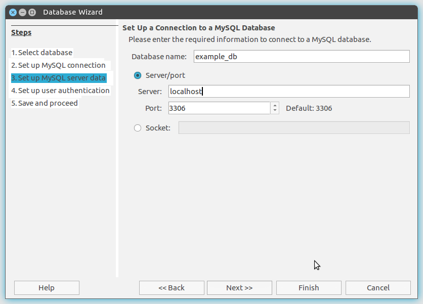

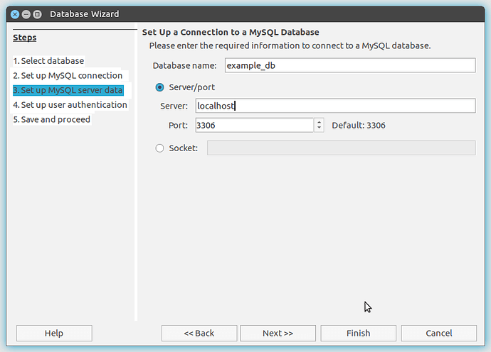

If MySQL is installed locally, then localhost is your server address.

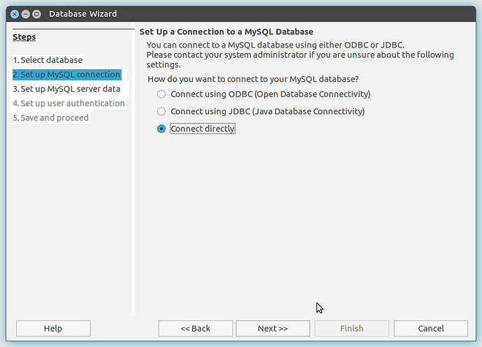

Working on mysql, created database name, created a table using mysql. I am now trying to connect to it using libra office base but need jdbc driver installed to connect to mysql. Could use some help here.
When you specify "Connect to an existing database", for the second step, choose Connect directly instead of the JDBC or ODBC options.
From there you can enter your server details to work with the database in LibreOffice:
My database wizard does not have an option of “Connect directly”?
Double check that some MySQL packages are definitely installed via a package manager, or even quicker by terminal:
sudo apt install libreoffice-base-drivers libreoffice-mysql-connector mysql-client
You will need to close and re-open LibreOffice if anything installs.
I also just discovered another tool for designing the tables is MySQL Workbench, available from the Software Boutique under the Programming category.
I installed the apt you suggested and all is good. I was able to access the database I created with MYSQL. Thanks, you have been a great help.
