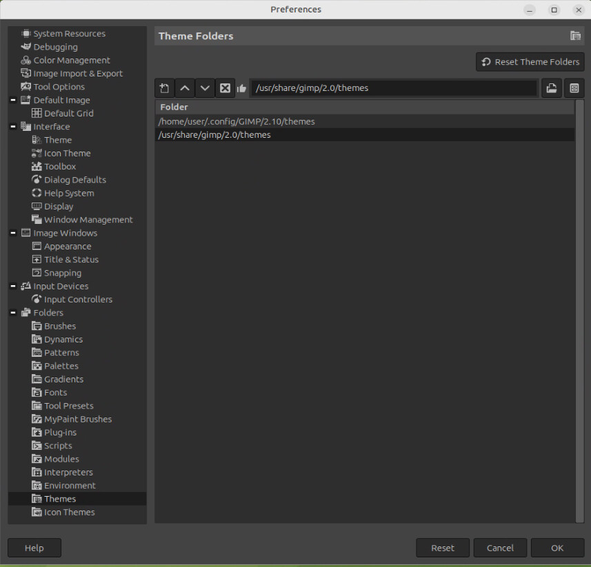

I installed gimp (sudo apt install gimp). It brought in gimp 2.10. Started gimp, exited gimp. I do not see a ~/.gimp-2.10/ dir. I can move the folders as described even though the README says Edit | Options but that should be Edit | Preferences. In Preferences there is a themes dir but its location is somewhere else.
The system-wide location is /usr/share/gimp/2.0/themes/ but a user location could be /home/andy/.gimp-2.0/themes/ I never used gimp; I don't have time to figure it out.

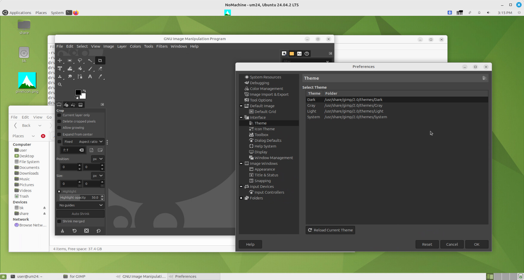

If you d/l the tarball in Downloads/ extract it there. Then open the "For GIMP" folder and cp those two folders into /home/andy/.config/gimp/2.10/themes/
Start gimp, Edit | Preferences. At very bottom, open folders + sign where you can tell gimp which folders to use.

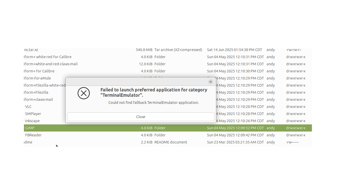

I made some changes to my Thunar's custom actions.
Now I can not go to a terminal for the current directory.
