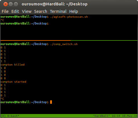

Maybe something like that:
#! /bin/bash
while true; do
    VBOX=`ps axu | grep "[a]gisoft-photoscan.sh" | wc -l`
    COMP=`ps axu | grep "[c]ompton" | wc -l`
    echo $VBOX $COMP
    if [ $VBOX -eq 1 ]; then
        if [ ! $COMP -eq 0 ]; then
            killall compton
            echo "compton killed"
        fi
    else
        if [ $COMP -eq 0 ]; then
            compton &
            echo "compton started"
        fi
    fi
    sleep 1
done
In a startup application (echo lines to be removed at your discretion.
