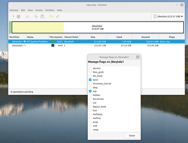

Boot off the live usb, run gparted, select nvme0n1. It shows 2 partitions, select the first one and look at the flags, it should have boot, esp. If not, enable them, tell gparted to do it. Then reboot.
example: my disk is sda

nvme0n1p1 is fat32 mounted at /boot/efi with 8.24 MB used and shows boot and esp flags.
