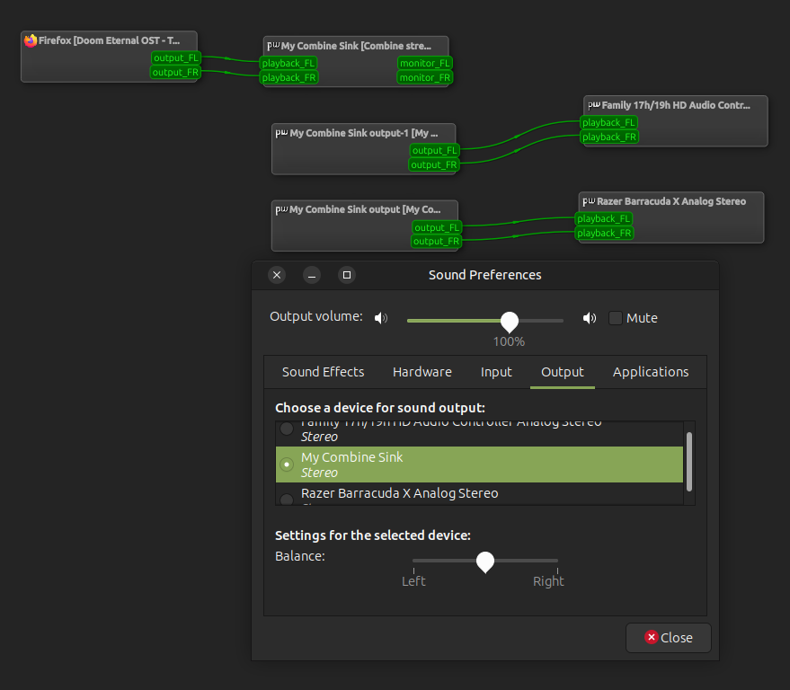

Using the .conf that I supplied earlier; here is a view of the 'graph' using qpwgraph, while I listen to a track on Firefox. It is playing through both my headphones and my laptop speakers (two devices at once). Also shown is the "My Combine Sink" output that is available in Sound Preferences:
Here is what pw-config shows:
user@host:~$ pw-config
  "config.path": "/usr/share/pipewire/pipewire.conf",
  "override.3.0.config.path": "/home/user/.config/pipewire/pipewire.conf.d/test-combine-sink.conf"

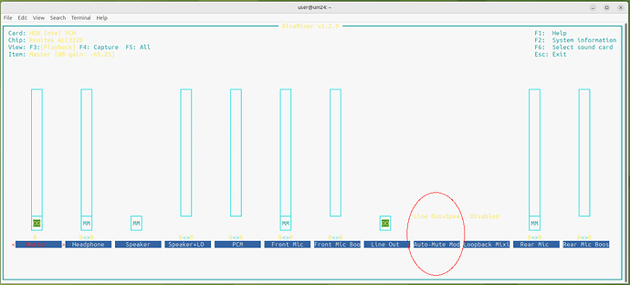

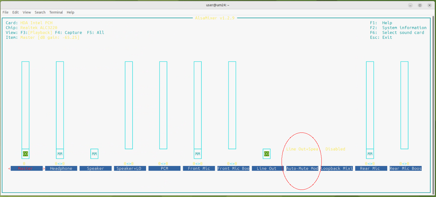

@stephematician provided example with a custom module for pipewire. For alsamixer, disable the auto-mute function. The reason is, when headphones are detected, it cuts the output to the green jack to the back of the pc. To disable this functionality, you disable it in alsamixer.

if you start alsamixer, press F6 until your audio card is displayed at top left next to Card: Then, you should see more options in alsamixer. In my screen auto-mute is 4th from the right. Make your terminal wide so you can see all the options of alsamixer.
