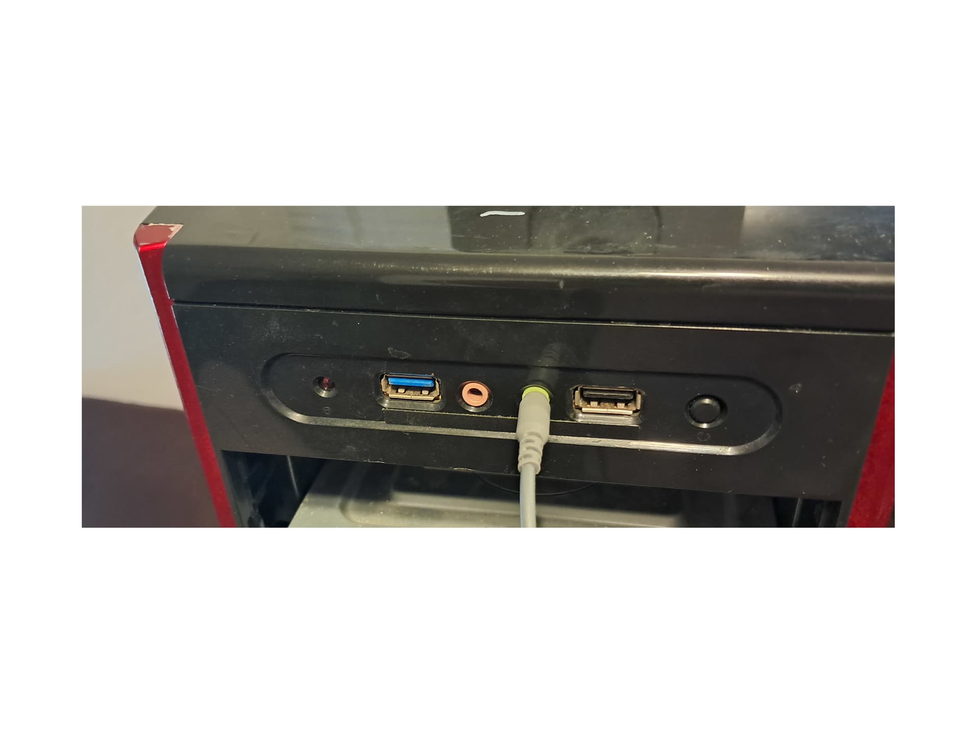

There is where I am plugging in my headphones.
Another green jack is used in the back of my computer for my Logitech sound system.
No sound is reaching my headphones.
Do I have to unplug my Logitech jack in order to hear thru the headphones?

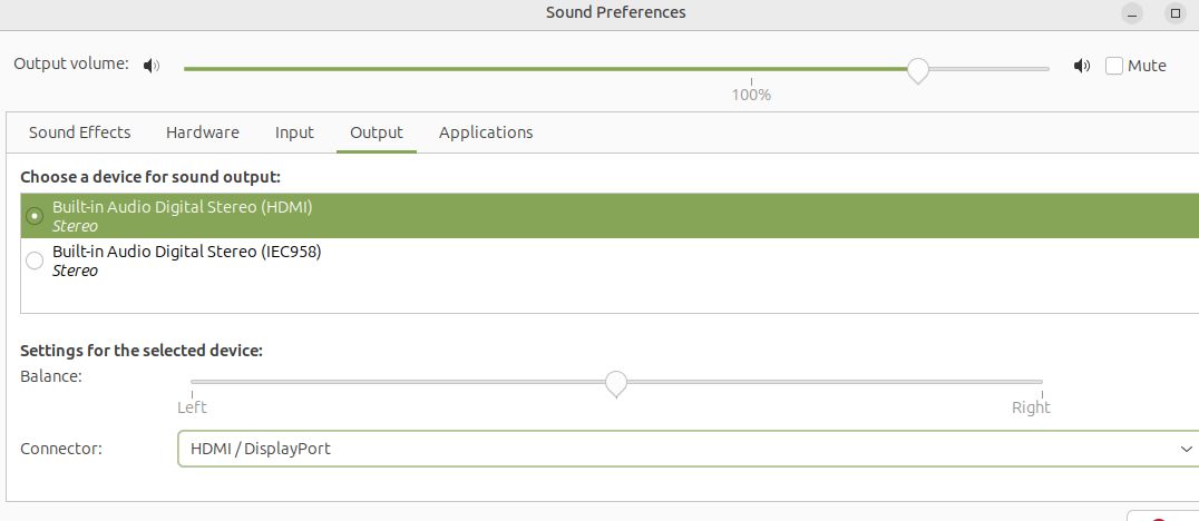

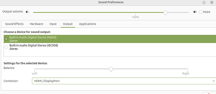

Sound Preferences is only letting you choose one or the other.
I bet if you click on the bottom one (non-HDMI), you will likely get your headset sound.
I don't know if there is any way to have both fed simultaneously, or if you can only "enable" one at a time. :frowning:
It did not help.

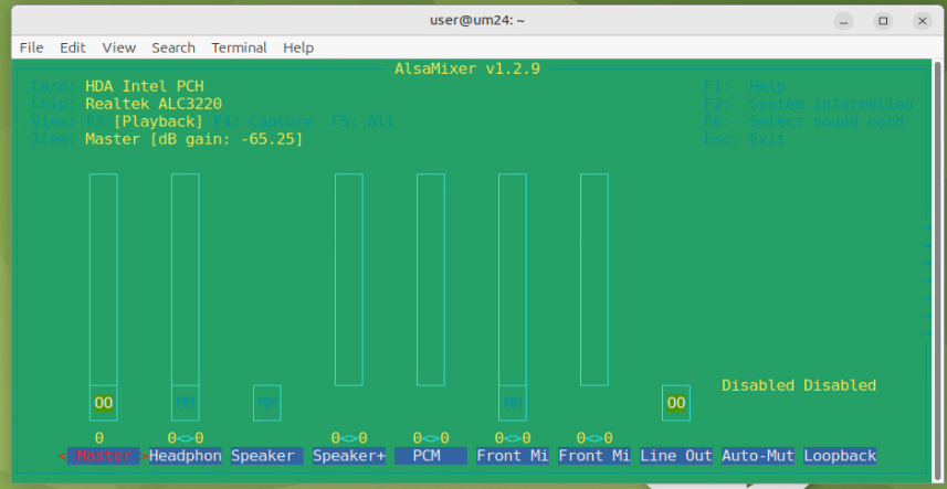

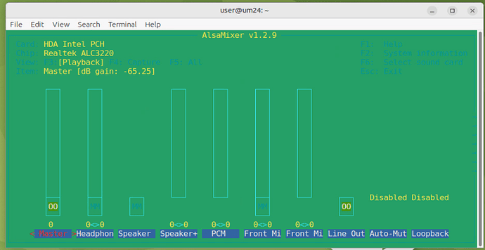

Start alsamixer, text based. Move to the right to Auto-Mute. Use the down arrow to disable both Speakers and Headphone. The text should read, "Disabled Disabled"
Then give some volume to both speakers and headphone and test.

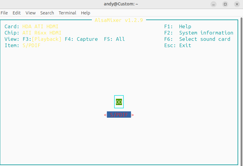

This is what I get. Why is that all there is?
I think you need to select another card, the current one shows HDMI
That's what I said in my last posting. :frowning:
Press F6 to select a different sound card.
