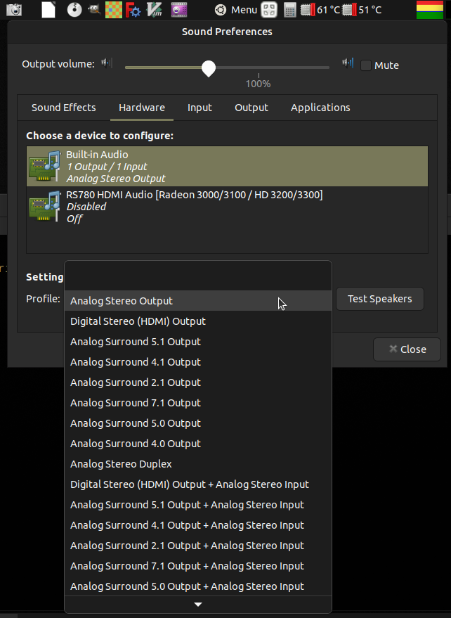

Also, be sure to select the correct choice (Built-in Audio for the 3.5 mm "sound jack") from the list offered in the tab shown below for "Sound Preferences" (HDMI would likely be the port that is currently selected and directing sound to your TV monitor):

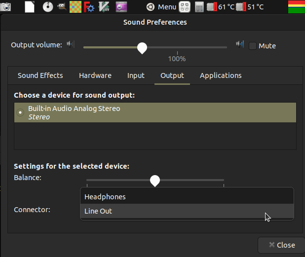

Also, when you choose the Output, since your external speakers have their own power-supply, make sure you chose "Line Out" and not "Headphones", as shown below:

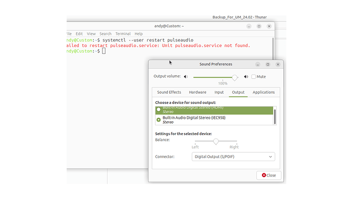

I am using UM 24.02.
I do not know if this will provide any useful info.
andy@Custom:~$ pipewire

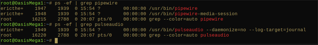

Also, for Pipewire/Pulseaudio, I have the following processes running on my machine:
If you have pulseaudio running as a daemon, I believe you need to kill that, then start Pipewire as a daemon, but that is only a guess! Notice the PIDs for startup sequencing.
On 24.04.2 the pulseaudio daemon should not be running.
You're likely using Ubuntu 24.04 or the 2024-April release, and your point release is .2, thus 24.04.2. There was no [new] Ubuntu-MATE release in 2024-February (24.02); with the only release that year/month being 22.04.4.
(22.04 used PulseAudio, 24.04 uses PipeWire; release does matter)

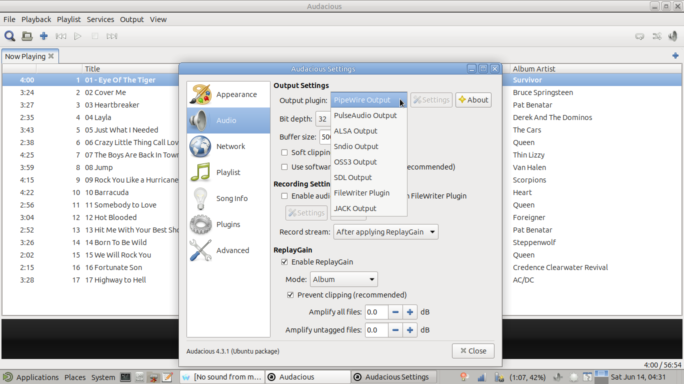

Andy this might help you. This is audacious. It is pipewire out. It took me a few months to figure it out when it first went from Pulse audio to pipewire.
