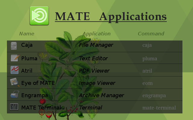

Here I created a short summary for everyone to remember the program names, done with GIMP! :grinning:
Please feel free to write if there is a problem with licenses. I have lost the know there.

Just because you made it, i printed i out :smile:. Thanks!
