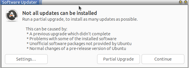

'Not all updates can be installed'
Although I’ve installed all 100% of updates every time, and although I’ve not added some additional repositories recently, etc., the last time (and also today) when I wanted to install updates I’ve got this message: ‘Run a partial upgrade to install as many updates as possible’.
What could be cause of this, and should I run a partial upgrade?
I’ve gone ahead and upgraded and not had any problems. I don’t know why it’s happening on this update. Perhaps it has something to do with the new Debian version.
I have had that occur occasionally with several versions of Ubuntu Mate.
I just do the partial upgrade and then run Software Updater again.
And all the software is updated.

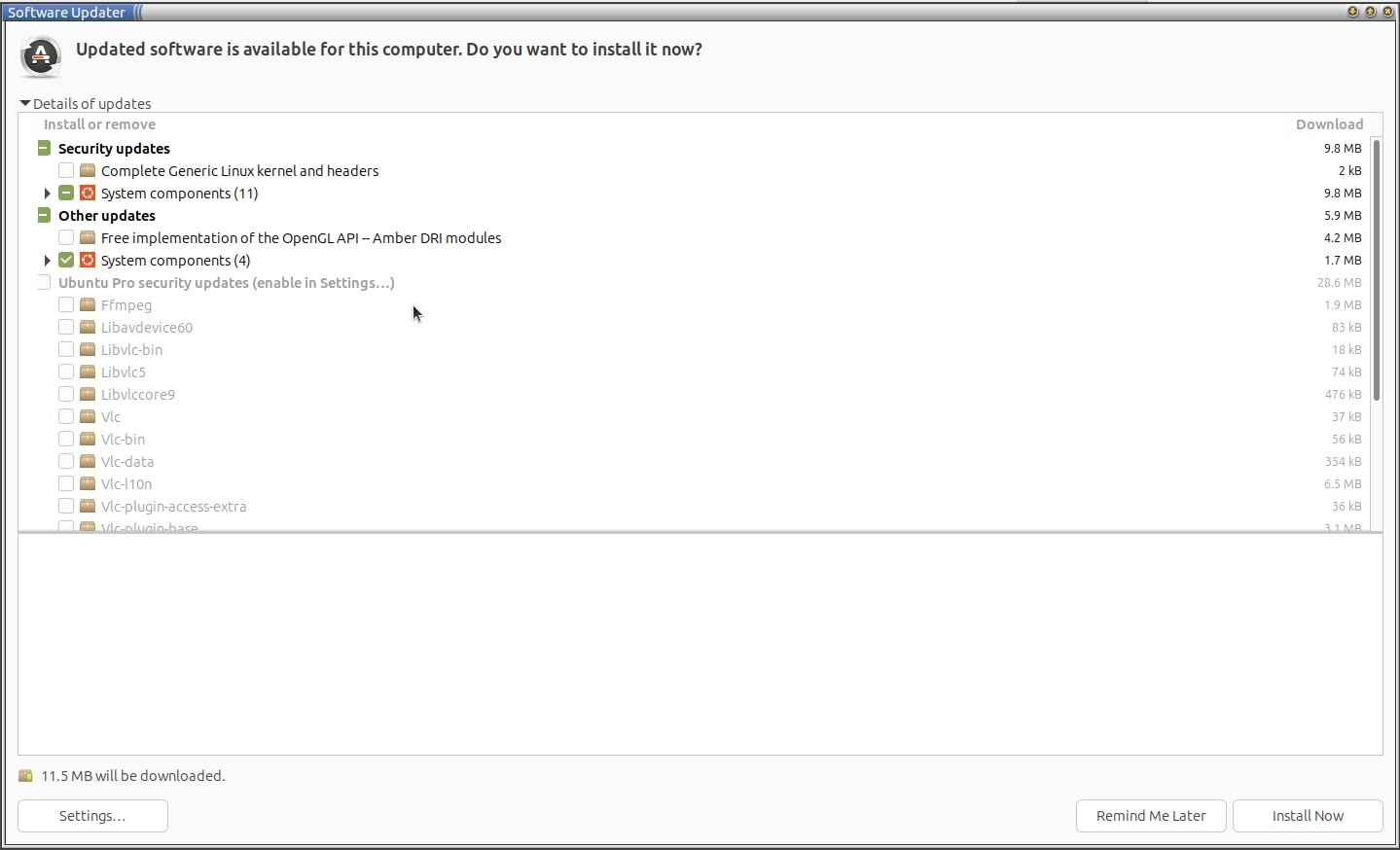

I also had that "Not all updates can be installed / Run a partial upgrade, to install as many updates as possible" Software Updater window in two laptop computers running Ubuntu MATE 24.04 LTS ("Noble Numbat") and, in both cases, it happened around the date that Ubuntu MATE 24.04.3 (the third "point release" of Ubuntu MATE 24.04) got released.
My guess (but I may be wrong!) is that it's related to the libgl1-amber-dri package that appears as a held-back package in the Software Updater. As @stephematician has written, in this same discussion topic, running the "apt" commands may provide clearer messages about what is going on. And that's what happened to me: specifically I found that I the libgl1-amber-dri package was both a package being "held back" / "kept back" and a package in the "autoremove" list.
So, I ended up solving this particular case by running sudo apt update followed by sudo apt upgrade followed by sudo apt autoremove (usually, I avoid running sudo apt autoremove particularly in cases when it seems to me that it's going to remove too many things and/or things that I may need):
