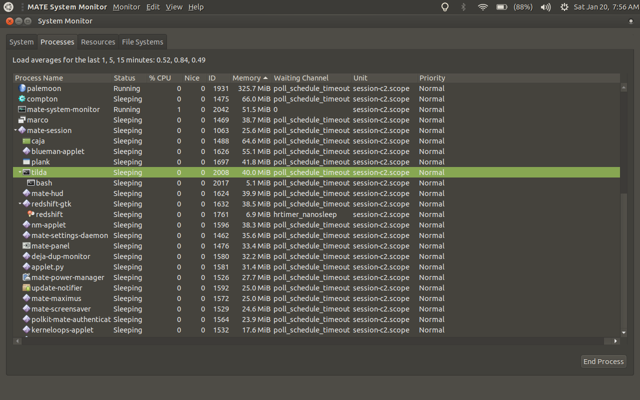

I started on a fresh boot with Tilda running on startup with the tilda -h command. After the UM loads up, I go to tilda and enter caja. Caja doesn't open and the tilda window automatically closes. I can't call the tilda window again using F12 however upon looking in the mate-system-monitor the tilda process isn't actually killed but sleeping.
