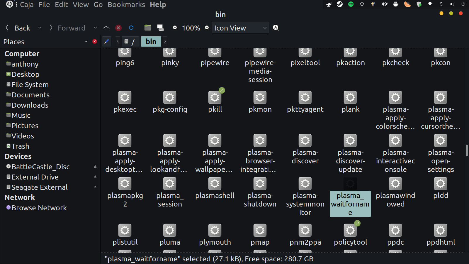

I changed the name in org.kde.plasma.Notification.service as suggested:
[D-BUS Service] Name=org.freedesktop.TestNotifications Exec=/usr/bin/plasma_waitforname org.freedesktop.Notifications
anthony@anthony-OptiPlex-9010:/usr/share/dbus-1/services$ notify-send "Hello"
Error calling StartServiceByName for org.freedesktop.Notifications: Failed to execute program org.freedesktop.Notifications: No such file or directory

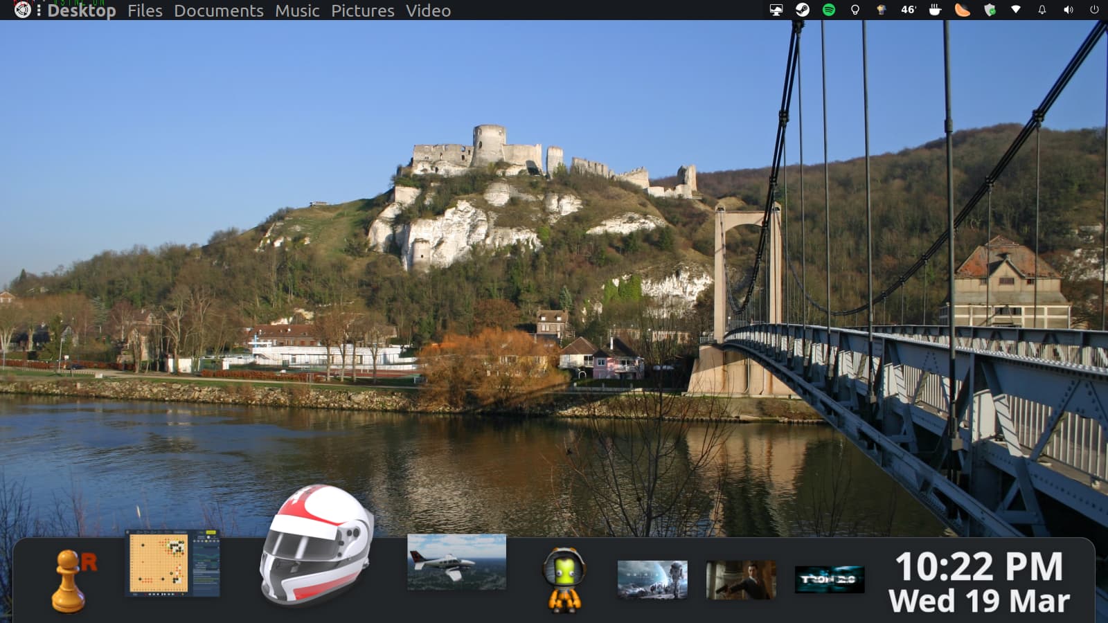

Ok, found the app requiring the KDE--it's the Latte Dock; I need to keep it because the clock is very big and I have poor vision.
The following packages will be REMOVED:
kinfocenter* latte-dock* plasma-desktop* plasma-workspace*
0 upgraded, 0 newly installed, 4 to remove and 0 not upgraded.
After this operation, 41.3 MB disk space will be freed.
I probably dl'ed it from Software because Cairo Dock wouldn't work anymore and I had a big clock there as well.
