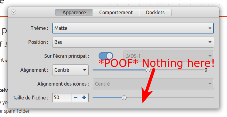

Today’s update (oct 12) of Plank Dock seems to have removed the magnifying glass effect, and the icons are always the same size, no matter which one you’re pointing to…

The window in the screenshot you posted is the one that appears when I click Plank’s icon in the dock… And it used to show the “Icon Zoom” option like the one in your picture… But now that’s gone… Even if I launch the preferences window from the Terminal…
