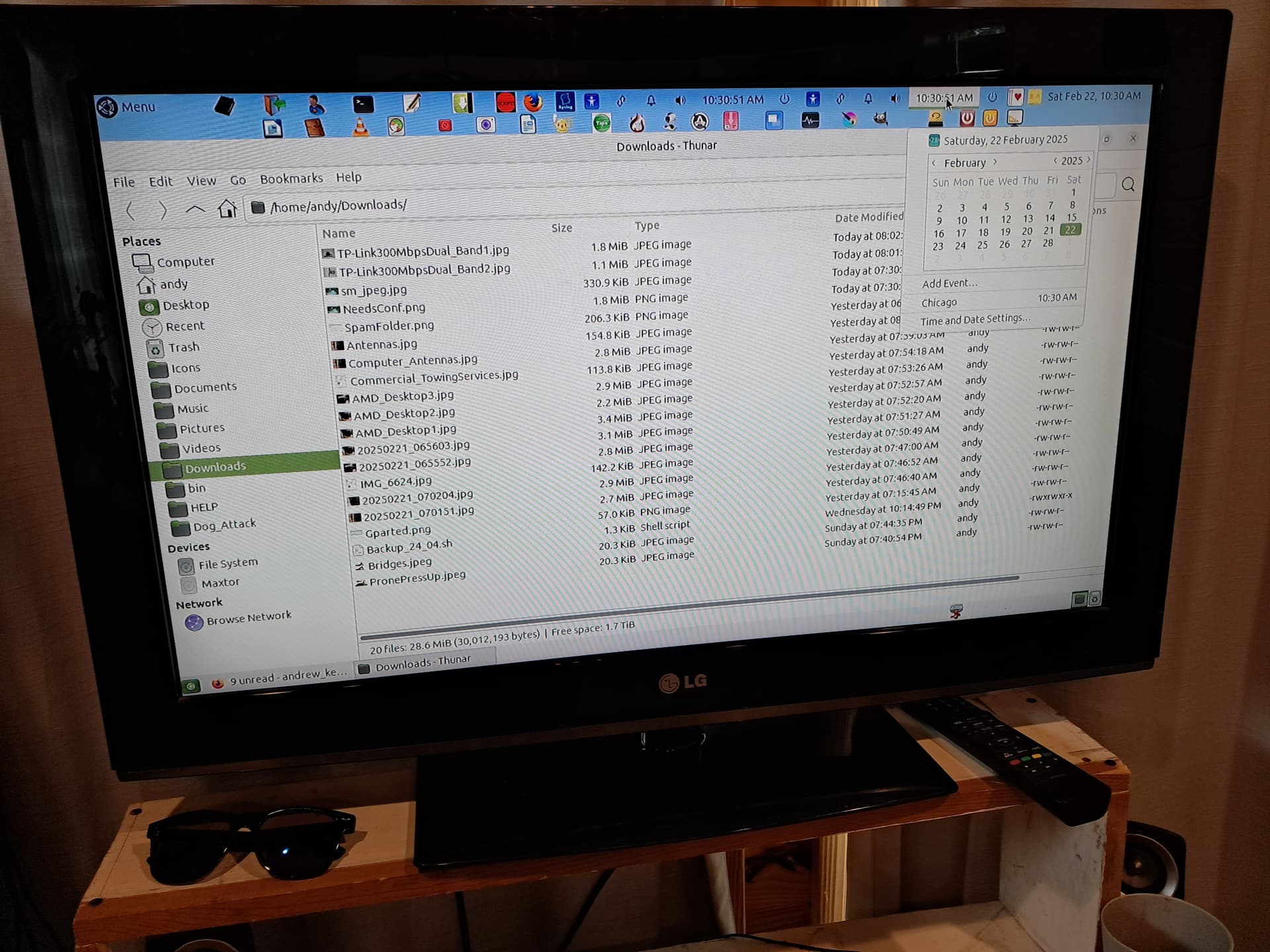

I would like to get rid of the time on the left.

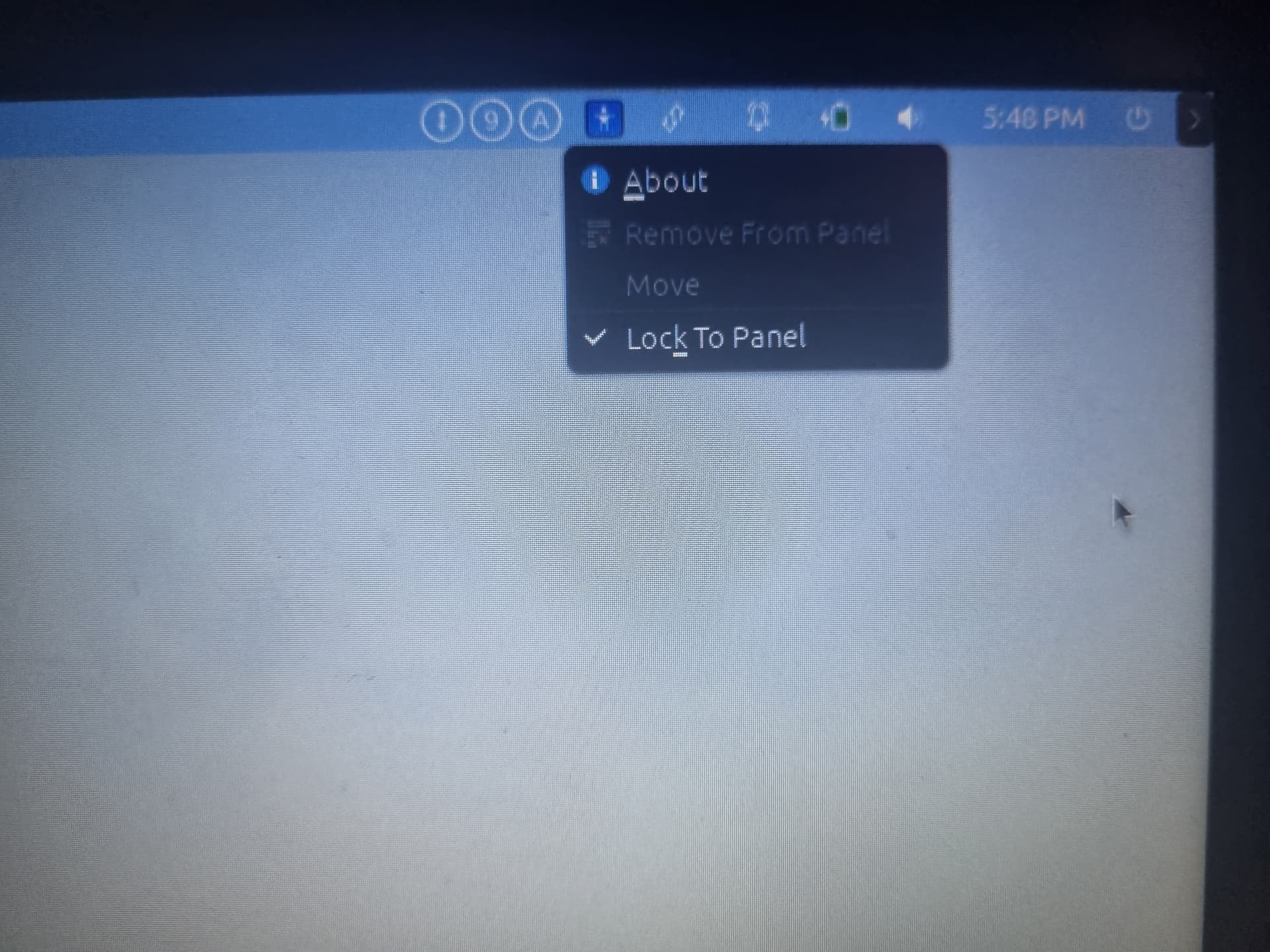

Try and right click on the thing you wish to remove from panel
Then choose option : "Lock to panel" and it will uncheck it
After it is unchecked it will allow you to choose an option "remove from panel" when you right click on the selected item from panel again

Second, if you RIGHT-CLICK - on any applet added to panel you should see this:
And when you click "Lock to panel" - it should unlock it and you will be able to press "Remove from panel"
The key word here is "should unlock it."

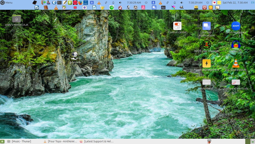

Several of the things I want gone, do not show "lock to panel."
It is not a big deal having two instances of the time in a panel.

The issue is that you have 3 panel applets that have a date component. The one on the right, not being associated with a Power button, must be the "Clock" applet.
The two on the left, which show the time as 7:30:29 AM, are each part of a combo App that includes
are all part of the "Indicator Applet Complete".
Since you won't have the "Power" button unless you keep one of those two, you will likely need to either

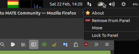

For mine, "Indicator Applet", the date is not an integrated component, which is why I have the "Clock" applet to the left of the other notification elements, as shown here:
If I were you, I would try right clicking on any one of the "Power" icon in order to obtain the expected menu
then click on "Remove from Panel" (for me, that overrides any "Lock", which is intended more for placement control than for protecting its existence on the Panel.

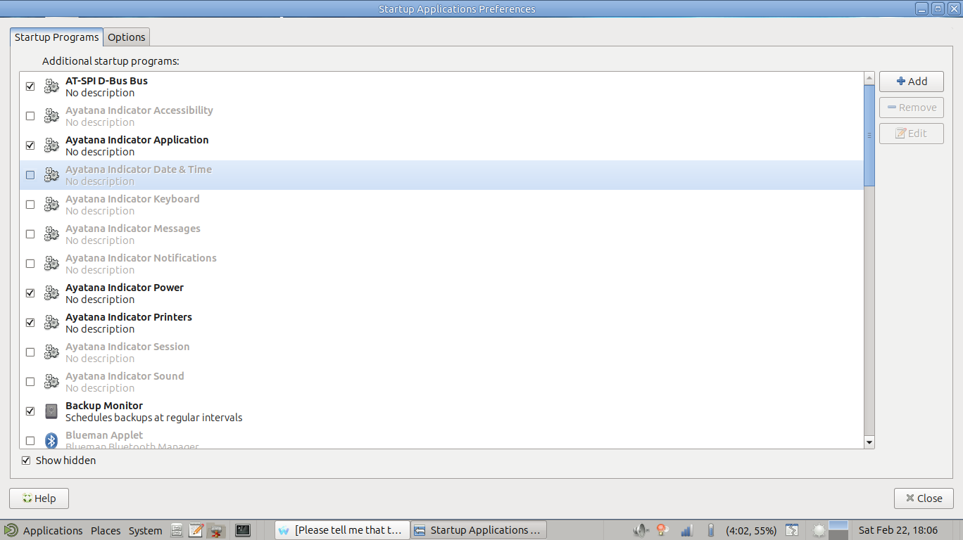

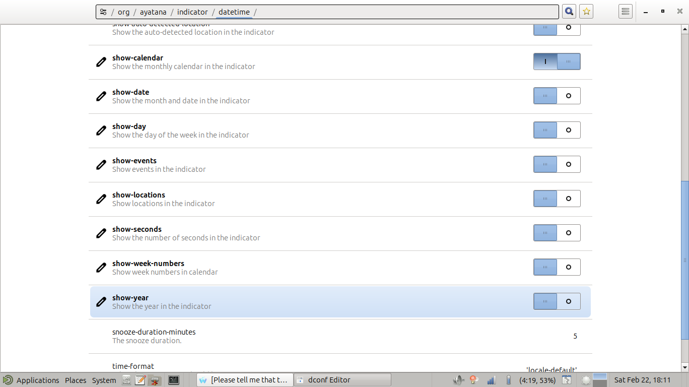

I disabled time on the indicator applet complete and use the clock applet instead, but you do not have to use that. Start up applications will do that for you.
Further cusomiztion can be done with dconf editor GUI:
