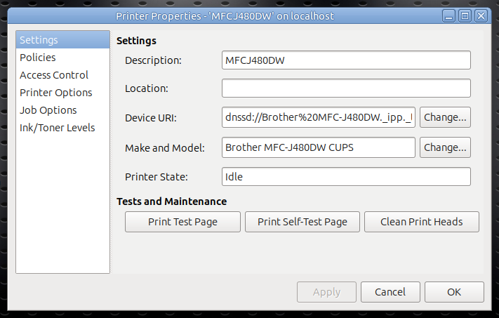

Yes mostly I believe they use the URI to find the printer that can be found at Printers>Properties on localhost> Settings>Device URI, but there should be a IP address too.
