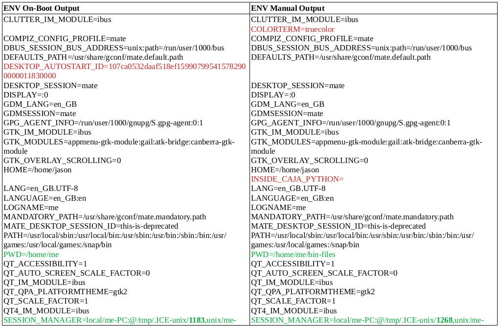

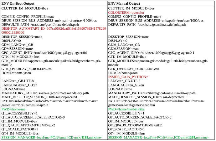

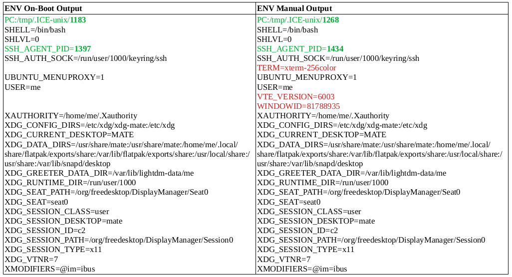

If it run perfectly when you run it manually and not automatically, i guess it can be related to env variables.
Try to send output of env command from the top of the script to a temporary file, back it up and next manually run it to compare the difference in the temp files.
