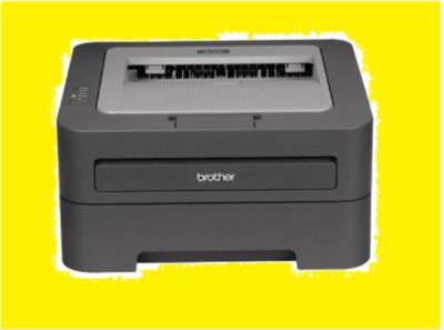

Brother HL-2240 does it.
Do you mean by the above that it will ‘just work’ right out of the box ??
AND=>
Is that HL2240 or HLL2240 ?? (‘Cuz my HLL2300D is a nightmare here.)
Yes.
You will need to buy a used one as they no longer make them.
I bought mine on Ebay.
Why go through a lot of aggravation when you can buy a printer that works?
