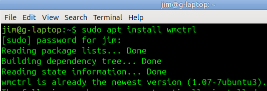

I installed sudo apt install wmctrl sucessfully.

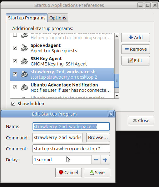

Strawberry did not start at all so I then went to system>preferences>personal>startup applications and made an entry for Strawberry and gave it a one second delay. It now starts but still on desktop one.
I am sure I am either missing something or don’t understand the instructions.

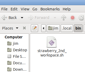

Also, a better place to store the script (conforming to convention) is in /home/jim/.local/bin
This has also the benefit of not needing the complete path to call it.
This command will take care of those things.
mv /home/jim/.config/'wmctrl -s1.config'  /home/jim/.local/bin/strawberry_2nd_workspace.sh

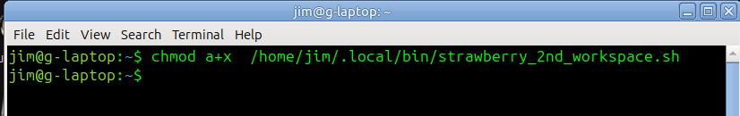

Sorry, I forgot to mention that you have to make the script executable.
Use this:
chmod a+x  /home/jim/.local/bin/strawberry_2nd_workspace.sh
The autostart entry should be then strawberry_2nd_workspace.sh
That is to be expected. You need to call the script, not strawberry directly.
The script is not a configfile. It is an executable program, albeit very short :slight_smile:
By the way, you can test the script from terminal: strawberry_2nd_workspace.sh

I still can’t get it to work.
wmctrl successfully installed:

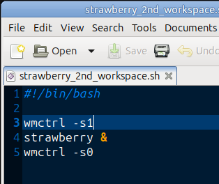

my Script:
Jim/.local didn’t have a bin folder so I created one by right clicking and saved the script in it.
I ran the chmod command:
I set Strawberry to open on startup.

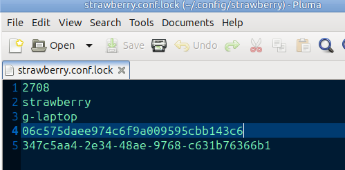

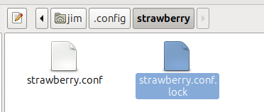

.config strawberry has two files
one that looks like I created it today by the date.
I am pretty sure I can delete that as sudo without a problem.

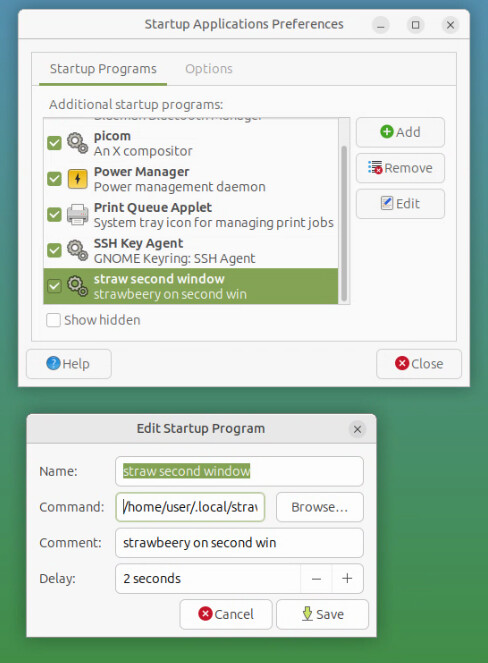

I did the following in my um24.04. My username is user
sudo apt install wmctrl strawberry
create a file, straw, in .local with contents wmctrl -s1; strawberry &
make that file exec, chmod +x /home/user/.local/straw
Went to Control Panel, Startup Apps, added "straw second window"
upon reboot, I saw strawberry in window 2
Hope it helps

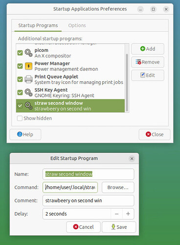

I made a file named straw and saved it to .local. It contained < wmctrl -s1; strawberry > I checked make executable and issued the command hmod +x /home/jim/.local/straw

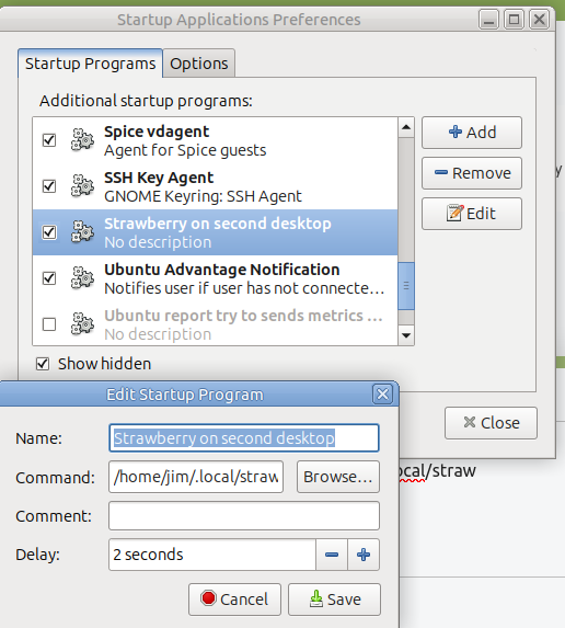

I set startup applications to:
On reboot, Strawberry did start on desktop two(2), but the OS also booted into desktop two (2)!
I was hoping the desktop would boot in to desktop one (1) and Strawberry into desktop two (2).
So I am back to where I started.
Maybe this just isn’t possible? If that is the case I am okay with it, as it will start and play when I boot up, I just have to click on the one (1) desktop which is still easier.

Edit your straw file and replace the contents with this:
#!/bin/bash
wmctrl -s1
strawberry &
wmctrl -s0
