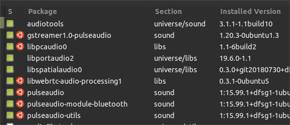

Using your preferred package manager, search for all currently-installed packages referring to "audio", then, from those, perform a full re-install of at least the Ubuntu "core" packages, the ones showing the orange icon, and also those which you feel apply to your circumstance.
Below is the list I got thru synaptic for my search:
