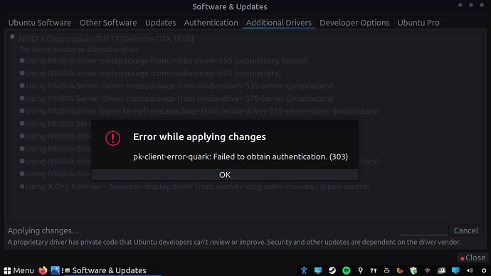

Sudo in terminal, Weird output, Today upgraded to 24.04
Hi, I just upgraded to 24.04 and am trying to add the included Nvidia driver, but after clicking Install, I am presented with a popup indicating error 303 about no authentication; I also entered the List Nvidia drivers in the terminal, which gives me some message I don't understand (screenshot provided).

Unable to run Software Update due to "Failed to obtain authentication."

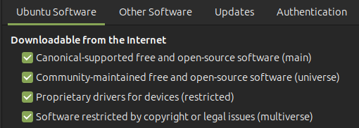

Can you confirm that you have proprietary (restricted) drivers selected in Software & Updates?
I could be wrong about GNOME keyring, it looks like the issue is more likely with polkit (which PackageKit uses, which I believe 'pk-client-error' refers to).
Thanks for the info. After I opened Firefox to see about disabling Screen Lock, I think I minimized it and couldn't get the icon to clear from the dock (I was using Mutiny).
I think the wifi quiting had to do with me just turning off the computer--I didn't think the action would do anything since Upgrade just downloaded packages and could just re-download them; I don't have a problem usually with wifi. The wifi issue is indeed fine now (6.8 is okay)--I guess upgrading to 24.04 from a recovery kernel (5.8) reconfigured/replaced the main version so that I don't have to use a recovery kernel for wifi.
In Ubuntu Software and Updates, all are ticked except for the listing of Source Code.

The "restricted" components should be selected, see "Components" in the output of apt-add-repository --list | grep ubuntu.com -A2:
URIs: http://archive.ubuntu.com/ubuntu
Suites: noble noble-updates noble-backports
Components: main restricted universe multiverse
URIs: http://security.ubuntu.com/ubuntu/
Suites: noble-security

The Nvidia driver is okay now. I have the screen-flicker issue I read about--I'll deal with that tomorrow. Still can't use the Additional Drivers method--with the message about pk-clieny-error-quark.
Sunaptic, probably due to the Authentication problem, is still not appearing.

FWIW: The error is definitely coming from PackageKit, which is trying to use polkit. See: PackageKit/src/pk-transaction.c at 09ef076e065ede945a3f827d6ba2b2b5889c9982 ยท PackageKit/PackageKit ยท GitHub
I'm not sure why lightdm is not able to unlock the GNOME keyring when you log in - that must be something that you've set up (because it isn't the default behaviour).
As far as I remember, @Anthony_Craig had the autologin option enabled for lightdm. When autologin is enabled, the login.keyring is not unlocked automatically.
