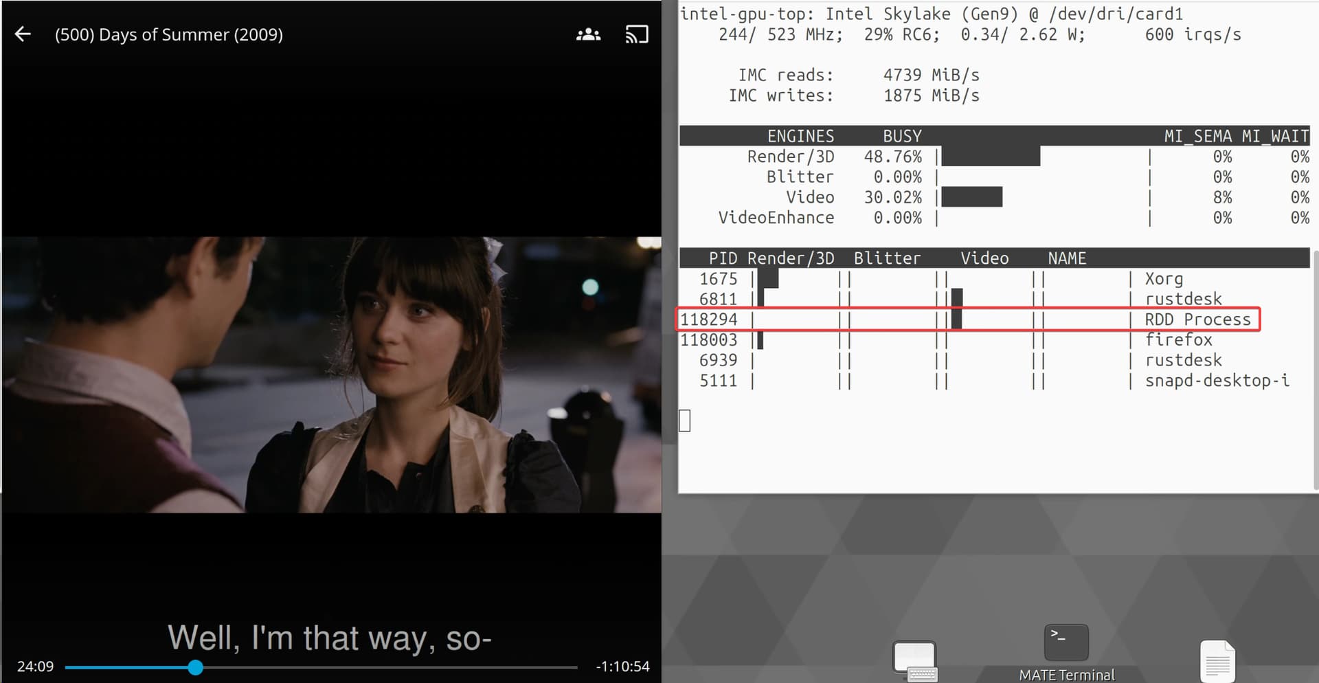

I tried watching a movie off jellyfin and I got to see some video action from “RDD Process” not sure what that is. Usually this would be a direct stream from the server. Still choppy and laggy though…

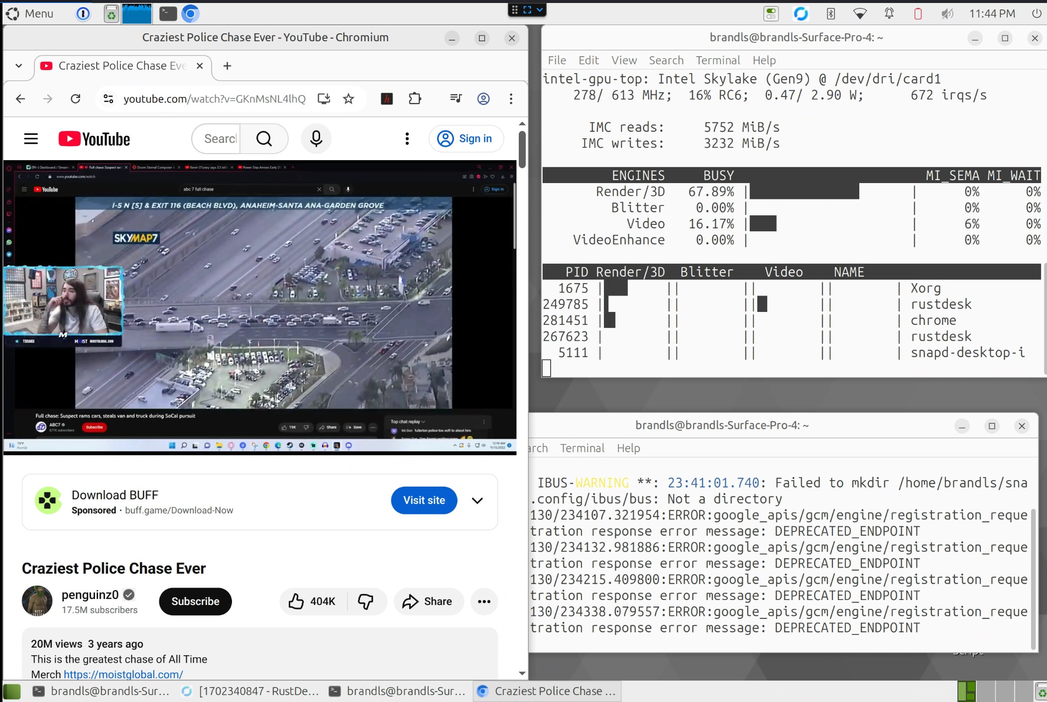

Running your command, I am still getting choppy playback and no GPU usage from chrome. I have the h264ify extension installed as well. I added some replies to the post above as well.
chromium --use-gl=angle --use-angle=gl
--enable-features=AcceleratedVideoEncoder,AcceleratedVideoDecoder,AcceleratedVideoDecodeLinuxGL
--ignore-gpu-blocklist --disable-gpu-driver-bug-workaround

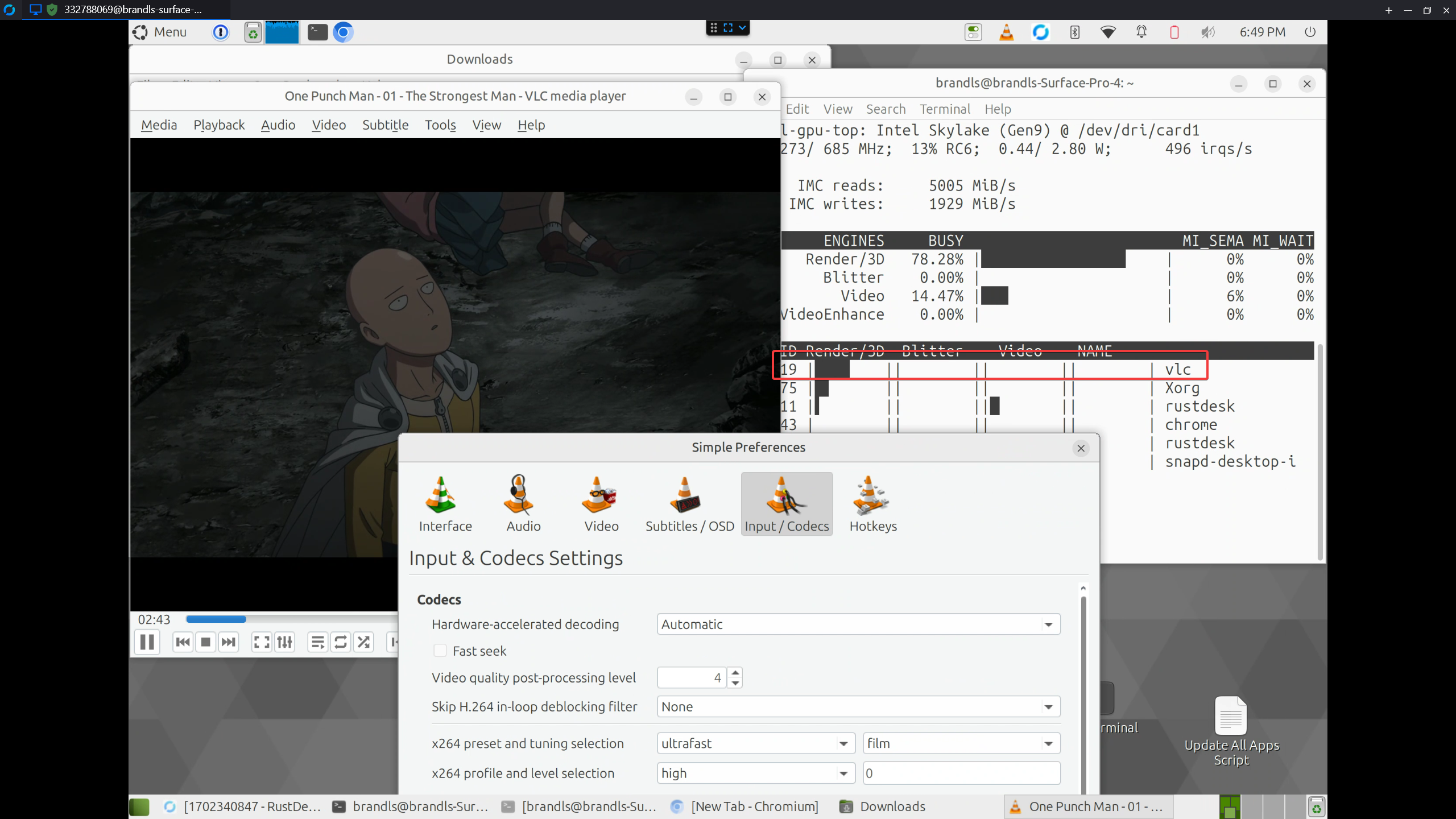

Running off of VLC is not working as well. VLC doesnt seem to be using the GPU for the video in x264 or x265

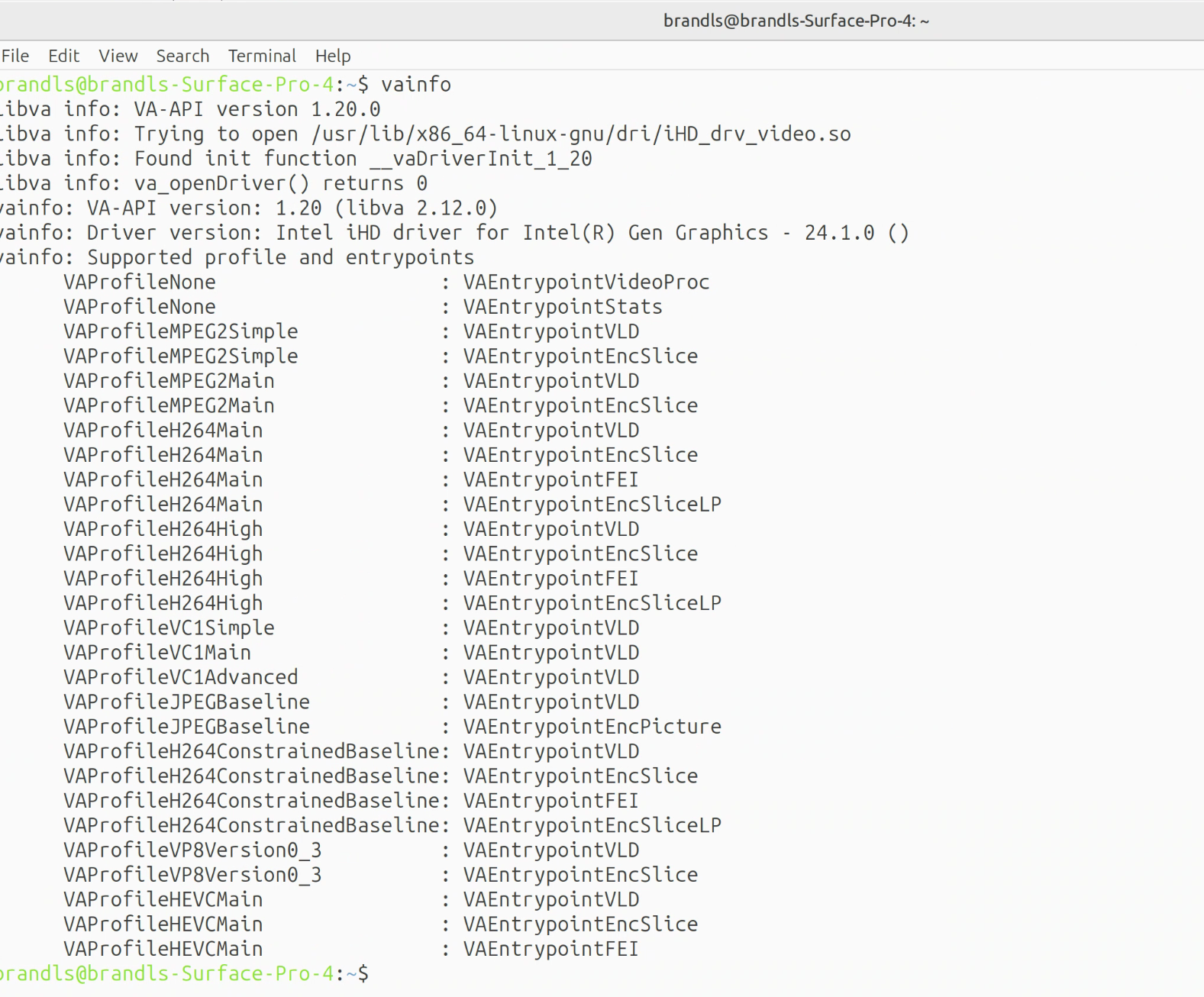

I ran sudo apt install intel-media-va-driver-non-free vainfo but I already had it installed, verified some comments above. Here is vainfo

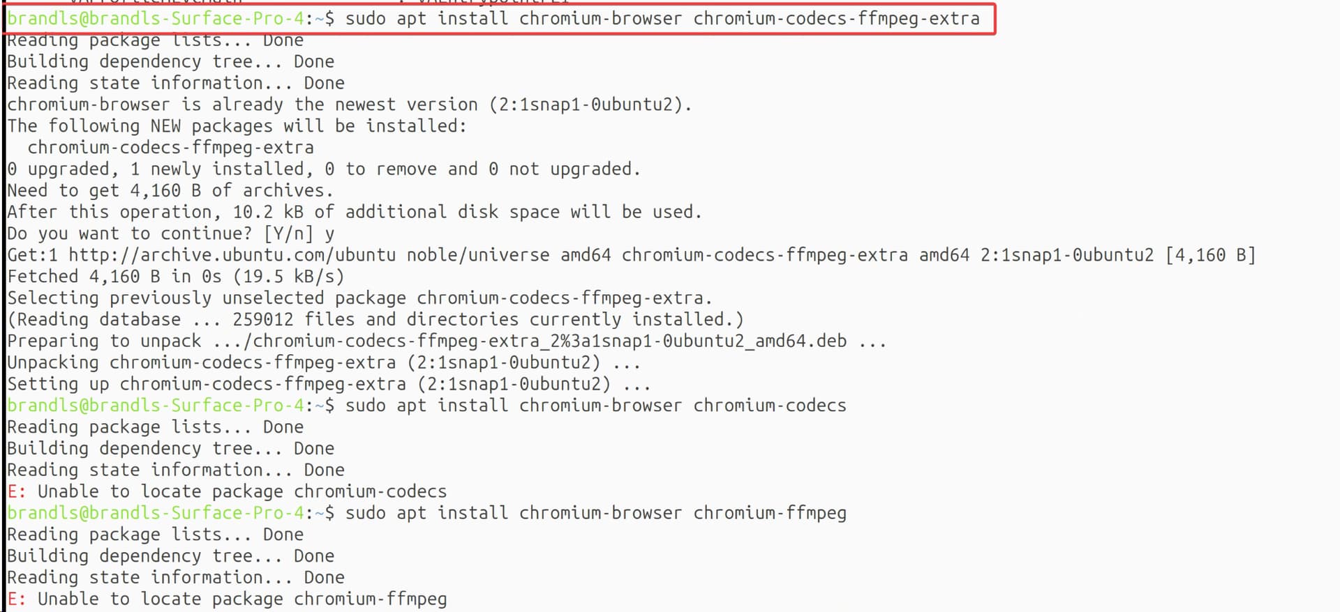

I then installed the package you suggested using sudo apt install chromium-browser chromium-codecs-ffmpeg-extra
I tried installing the package that stephenmatician had suggested (chromium-ffmpeg) but it wasnt found. I launched chromium with chromium --enable-features=VaapiVideoDecoder
Unforuntely I am still getting studdering and lag, chrome still isnt using the iGPU.
I wanted to mention too. I tried watching a download x264 and x265 video using VLC, it was also choppy and studdering. I have some comments on the post above yours of screenshots of that.
I am not sure it is the wifi hardware. I did watch something off of my jellyfin server and it seemed to use the igpu, but it was still laggy and studdering. I watched x264 and x265 videos downloaded off of the server as well using vlc but it was still laggy. I commented above with screenshots
I tried to install that but wasnt able to see the package, see my response to GeekBones orginal comment of my results. Also take a look at my testing with VLC and downloaded media, as well as testing watching off of my jellyfin server. It seemed to use the iGPU but was still studdering and laggy.. This is a mess
