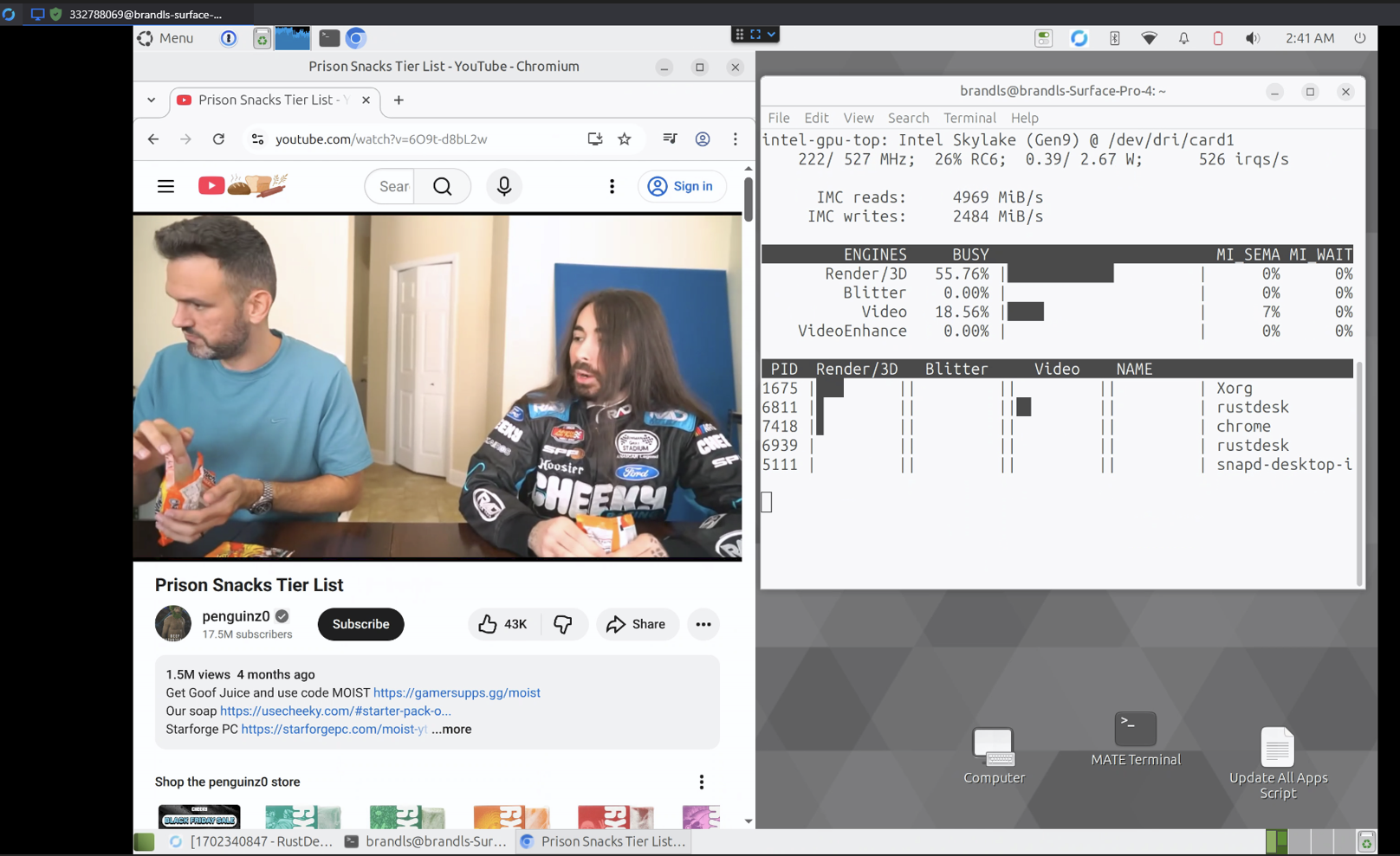

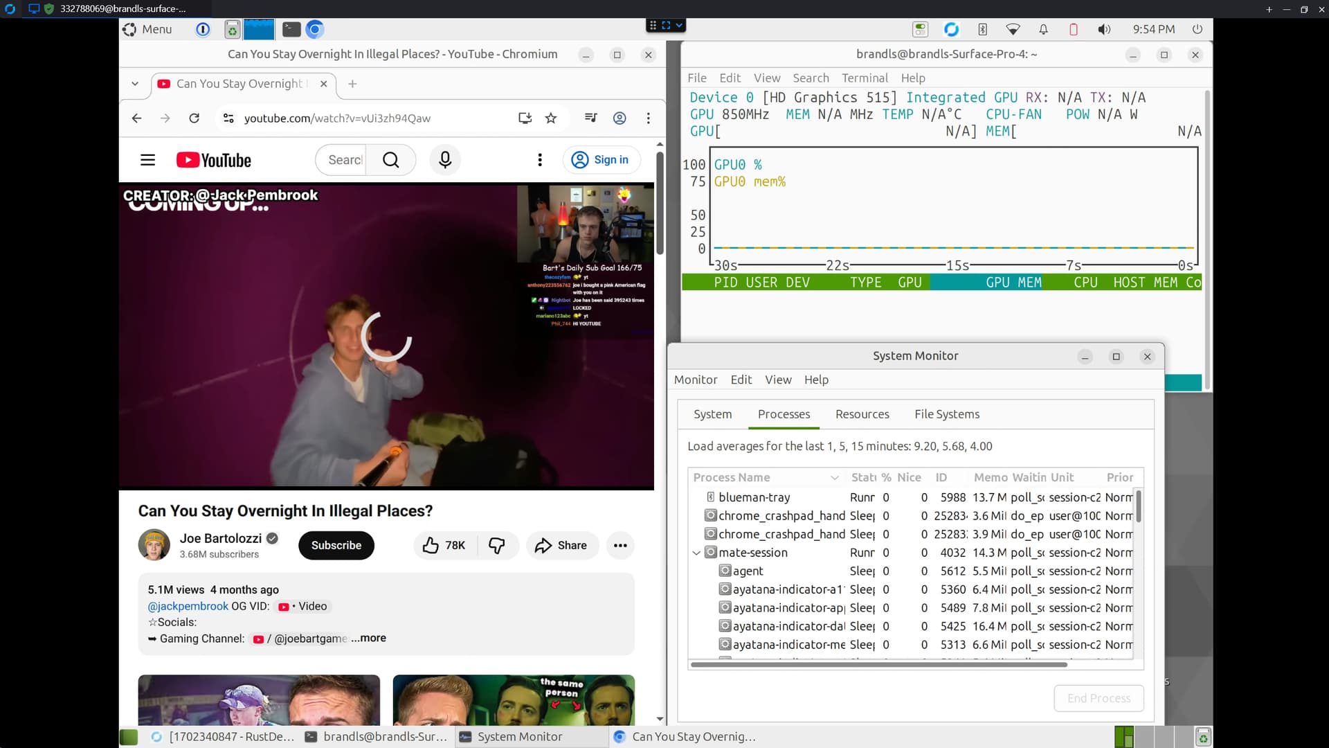

Looks good to me. One thing to check might be nvtop while youtube is displaying. See if the video card is getting a workout or not.
My guess is that Chromium and youtube (website) are so heavy with javascript that its not the video playback that is causing stutters - it would be all the other bloat.
As in - if you grabbed any demo H264 video and played it through ffmpeg or vlc, itd play fine.
I dont think the GPU is being used at all, I had no issues playing youtube on windows.
I will download something off my jellyfin server and see if I can play it with VLC
Looks like nvtop is having trouble reading the GPU utilisation anyway, damn.
Could be that a newer version of nvtop is needed than what's available in the Ubuntu repositories.
Try intel-gpu-tools and the intel_gpu_top command?

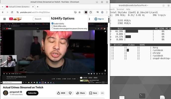

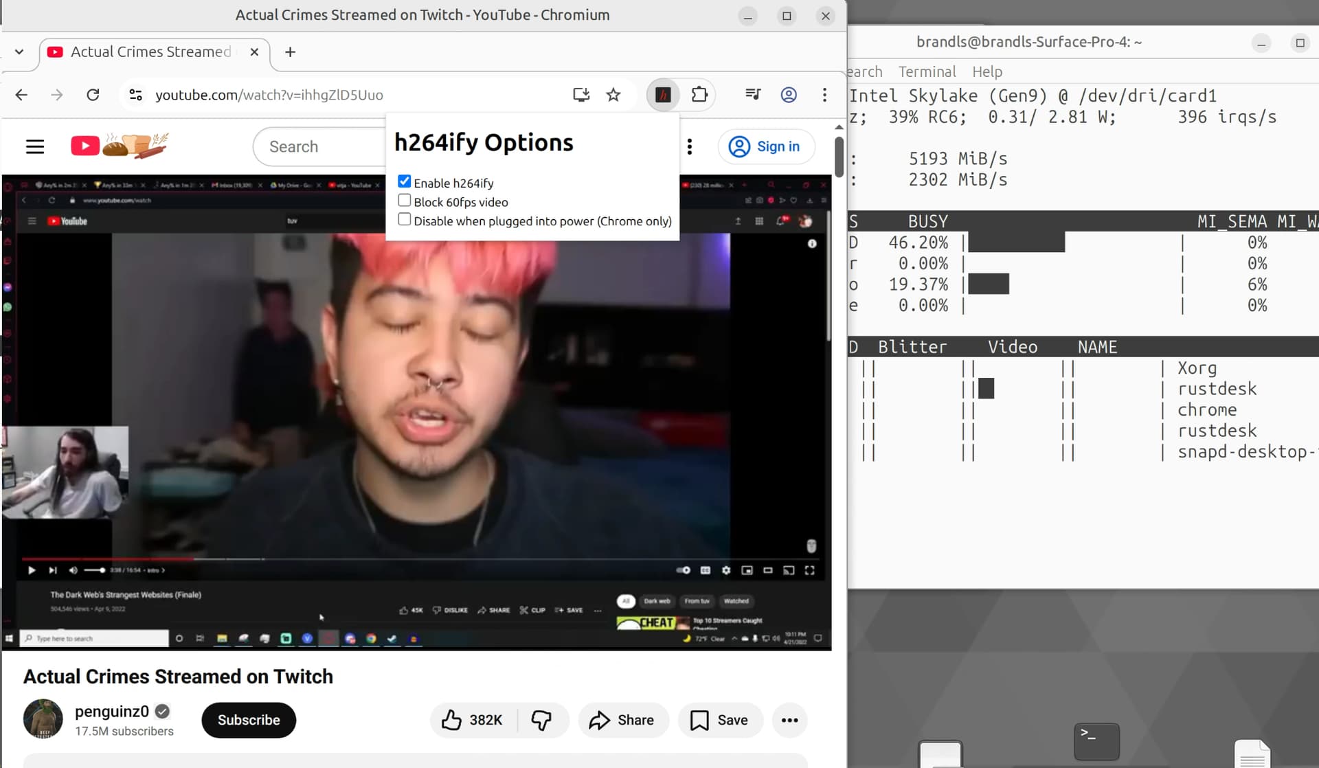

Here is what I am getting, I get the same results remote / not remoted in using rust desk. Still a laggy mess. could it have to do with AV1 decoding from youtube? Feel this is a driver issue. didnt have crazy lagy on youtube otherwise using windows 10.
I would think that youtube would use H264 if its not being given access to AV1 hardware decoding.
If its a driver issue - its interesting that rustdesk is showing some video utilisation with intel_gpu_top, right? Perhaps there's a chrome setting that is preventing the use of VA-API (which is one way for a browser to access hardware decoding on Linux).

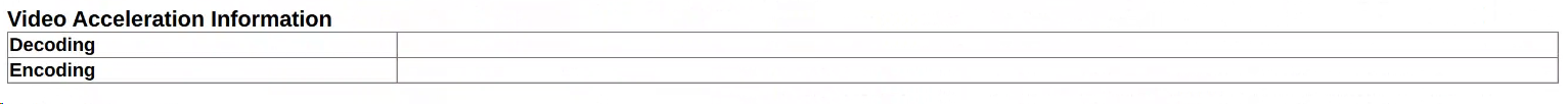

I have tried a few of these already. I went ahead and looked again. Following this section -
Verify the VaAPI supports and/or uses a given codec
A few steps are customary to verify the support and use of a given codec.
To verify that the build and platform supports video acceleration, launch Chromium and navigate to chrome://gpu, then:
  • Search for the “Video Acceleration Information” Section: this should enumerate the available accelerated codecs and resolutions.
  • If this section is empty, oftentimes the “Log Messages” Section immediately below might indicate an associated error, e.g.:
    vaInitialize failed: unknown libva error
    that can usually be reproduced with vainfo, see the previous section.
I see :
The log message seems to be generic and not related to any issue. Looks like my hardware doesnt support video acceleration decoding or encodiing at all? It looks lke it should be supported though for decoding at least.

update - tried some tips from a reddit post https://www.reddit.com/r/linux/comments/xcikym/tutorial_how_to_enable_hardware_video/
Using these flags to start chromium does not seem to allevate the issues
chromium --use-gl=desktop --enable-accelerated-video-decode --enable-accelerated-video-encode --enable-features=VaapiVideoDecoder --disable-features=UseChromeOSDirectVideoDecoder
I also tried installing the h264ify browser extention along with launching chromium with those flags above, still laggy and studdering. Still doesnt look like the browser is even using the gpu at all while rust desk continues to use it.
update - tried the firefox config from the reddit post https://www.reddit.com/r/linux/comments/xcikym/tutorial_how_to_enable_hardware_video/
went to about:config and set gfx.webrender.all and media.ffmpeg.vaapi.enabled to true. I restarted firefox and still having studdering playback on youtube. Doesnt seem firefox is using the igpu as well
