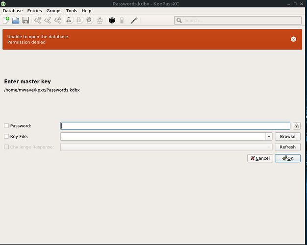

I don't know why it's not woking on my end. I put the folder in home directory to separate access. And I do have a group with both users assigned to it named "keepassusers". The owner of the directory and files is still the first user. Here, take a look...
Super strange. Do you see it in caja from second user?

That screenshot is from the second user’s desktop. Works fine on the first user. They both have identical permissions in “Users and groups” and the directories are not encrypted.

Permission denied when opening with Caja.

Okay, I replaced snap version with apt version and still does not work. I discovered though that file access in Caja shows an em dash "—" so I tried selecting "Read and write" but it keeps reverting to the dash, even when running Caja as superuser. Perhaps this is where the problem lies?
@brokoli: I finally got it to work! I was changing file access in Caja on the directory level instead of the file level. So I went into the folder, right clicked the database and changed file access to “Read and write” and I can now open the database using the other user profile!
