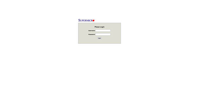

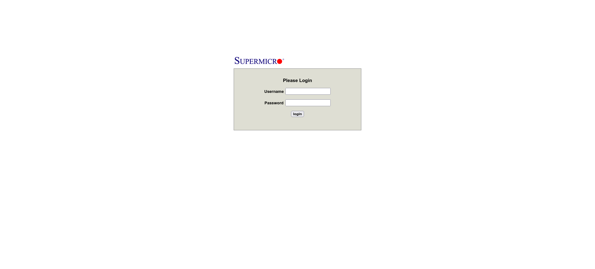

You should have 2 ip for that server, one is for its name and another for the ipmi interface. pve9 is a proxmox server. From your browser, http://10.0.0.56
pve9.lan                  => 10.0.0.9
supermicro.lan.           => 10.0.0.56
Login page
In my case, ADMIN/ADMIN, there are other variations of user/pw, depends on your server.

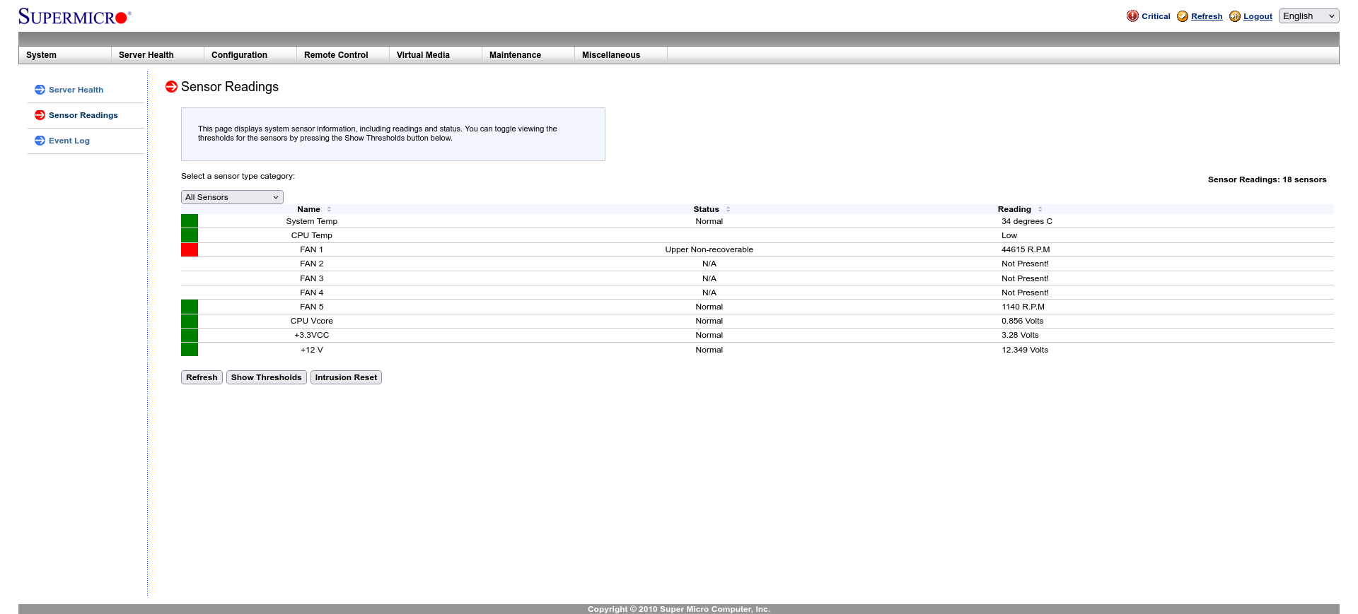

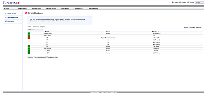

Second tab, Server Health, on the left Sensor Readings
I have an issue with FAN 1
There are other options as to power on/off the server. Even if the server is turned off, IPMI is active so you can log on and power on the server using the IPMI.
