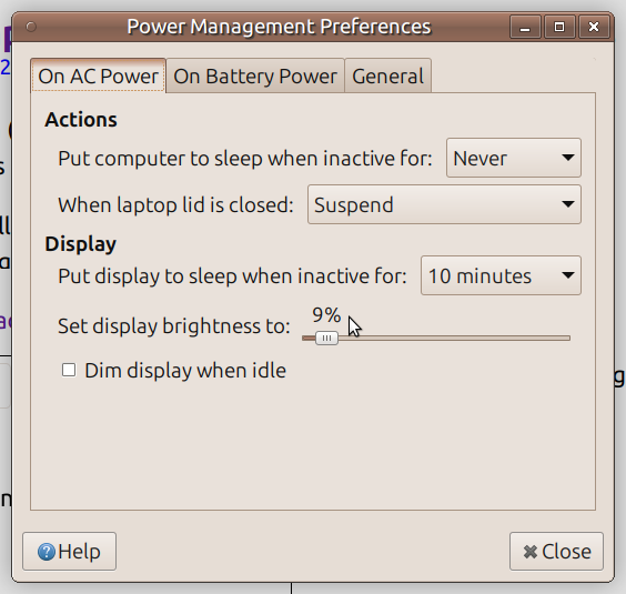

Ubuntu Mate GUI laptop brightness control belongs to Power management menu dialogue.

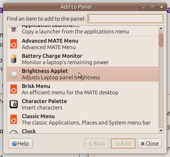

It is also possible to add LCD Brightness applet to Mate panel

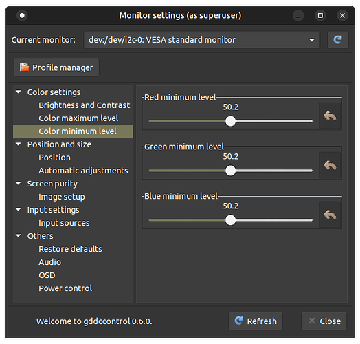

Sometimes another option: DDC/CI
This can remote control monitor hardware settings. You can also control RGB separated.
Some (external) Monitor support this feature. Check your Monitor specification or manual for "DDC/CI". Or simple install and try one the programs:
With GUI: ddcui gddccontrol
No GUI: ddccontrol
You must start it with sudo.

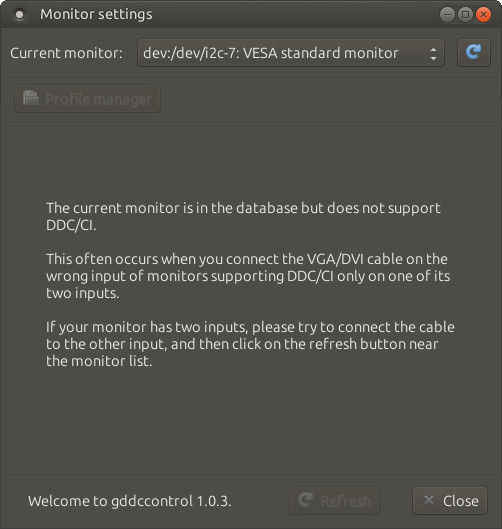

In my case, there was no ddcui to be found, but I did find
  • gddccontrol
which presents as the following on UM 22.04.5 :
Ow, that's a bummer; gddccontrol does not work here. My monitor is probably too old because of buggy firmware (which I mentioned before)
I only have one DVI_D and one VGA on my monitor
(VGA not in use because, there is no VGA on my AMDGPU)
No problem however: your script does the job perfectly. :slight_smile:
