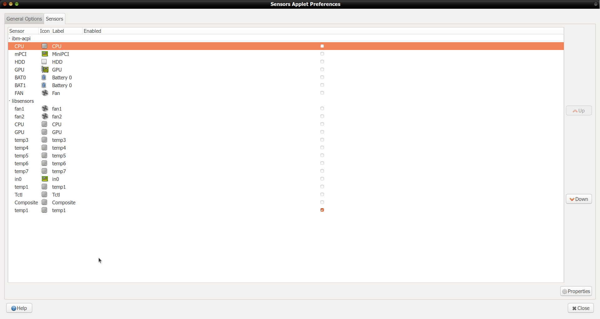

I did discover something called Thinkfan which has a GUI but I don't really understand the documentation that well. Also heard that tlp would be useful here so I installed it and I don't know if it's helping or not?
Both of these are interesting, "k10temp" is your APU (CPU+GPU)
I don't know what "thinkpad" is supposed to be. Casefans perhaps ? Or a master controller for everything ?

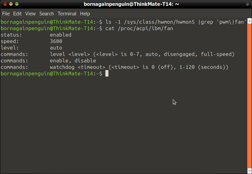

You might also want to try this:
ls -1 /sys/class/hwmon/hwmon5 |grep 'pwm\|fan'
You mean this one ?:
It might work on your laptop if you have a file or directory called /proc/acpi/ibm/fan
You can check this by issuing this command:
cat /proc/acpi/ibm/fan
If such a file or directory exists on your system, you can download the .deb and install it, create the /etc/modprobe.d/thinkpad_acpi.conf as explained in the description (if it isn't enabled yet) and it is supposed to work probably after a reboot.
If it doesn't, look here: [SOLVED] Thinkfan and sensors simple problem / Newbie Corner / Arch Linux Forums

First command does nothing, second one:
Am checking out the thread now..

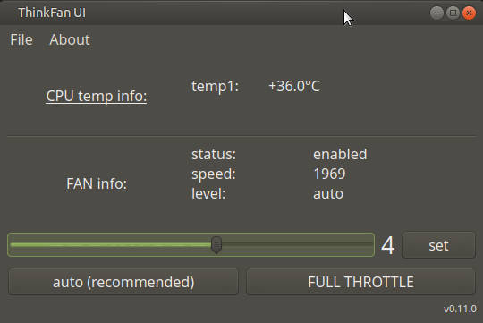

You are ready to install this software for your needs:
Hi @bornagainpenguin
I installed the formentioned app on my Thinkpad T420 without any further tinkering or editing things and besides the fact that it is very simple to use, it works like a charm.
I have it installed now. Is there a way to get it to display in Fahrenheit? Or to launch without needing to have a password entered? Asking because I'd like to be able to get it to be part of the startup applications. I just don't know how to set the permissions.
Not that I know of. The API of the driver works with °C values, but you might ask the author of the software on github (see link above) if he wants to add extra code to do the conversion for you (or you hack the code yourself).
