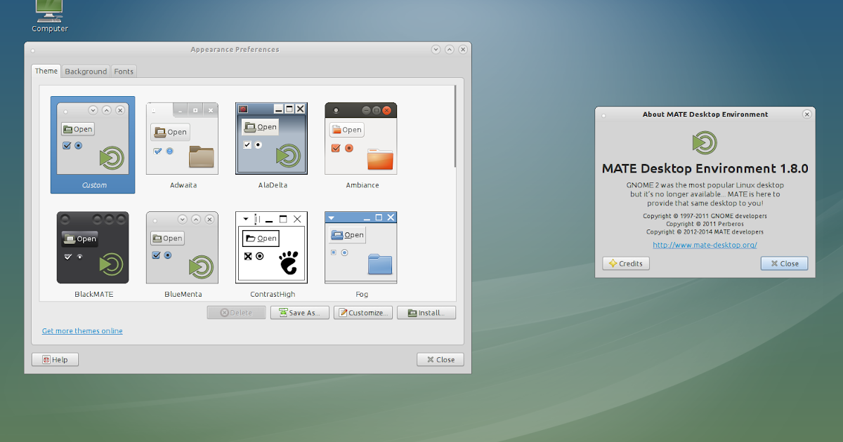

My most important concern is that the display is wrong. I don't know why.
The panels are black, the indications are merely lisible, the wallpaper disappear 2s after I changed it.
The only readible theme is BlackMATE, the others are stripped...
It is a mess.
I took screenshot to show you:
Not bad ? It is the screenshots.
What I have is that (taken with my cellphone):
Anyone as an idea to fix that ? I don't even know how to characterize it.

I was able to make a first image, to boot on and then install mate on it:
It is really light at boot (but there isn't much installed for now).
And I had a surprise (I guess it will talk to you @Wimpy):
Do you see it ?
