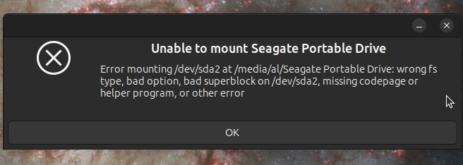

After transferring some files on my Seagate One Touch I remove drive on the right click on the mouse and it did not unmount soon enough and I unplugged it. I got a message saying something about not able to unmount the drive and I shut my computer off. I try to mount It And I get this messge
Error mounting /dev/sda2 at /media/al/Seagate portable drive:wrong fs type, bad option, bad superblock on /dev/sda2, missing codepage or helper program, or other error
Is there anything I can do to fix this problem? I’m not experienced with the command line. Thanks in advanced

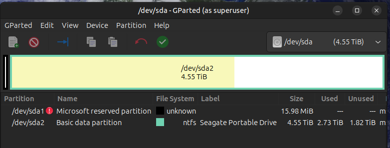

Al, did you perform the fsck on all the partitions that exist on that device? If I am not mistaken, there should be
  • /dev/sda1
  • /dev/sda3
Pavlos, (@pavlos_kairis ), would the use of the command line parted (NOT gparted) be recommended at this time?
Specifically, is there a sequence to re-write the partition table that has been verified good, in order to overcome the error being reported?

al@al-ThinkPad-T16-Gen-2:~$ sudo ntfsfix /dev/sda1
Mounting volume... NTFS signature is missing.
FAILED
Attempting to correct errors... NTFS signature is missing.
FAILED
Failed to startup volume: Invalid argument
Trying the alternate boot sector
Unrecoverable error
Volume is corrupt. You should run chkdsk.
chkdsk, isn’t that a Windows program? In Gparted, couldn’t I format sda1 to ntfs?
