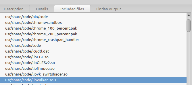

According to this, there should be a /usr/share/code/ directory, but it does not exist.
Does that mean that the .deb was not installed?
