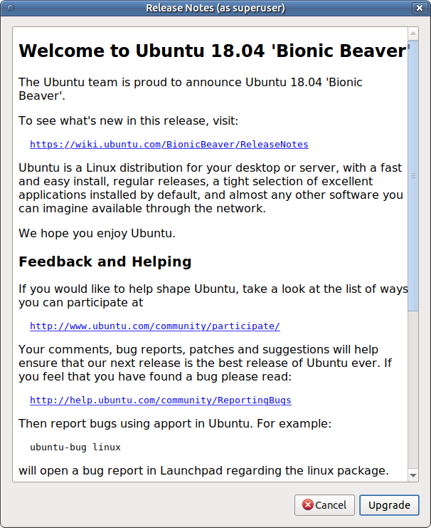

Edit 3: To correct this ignore list business, I clicked on Control Center, and then on Software Updater. It displayed the following:
Clicking on Upgrade.. displayed an authenticate dialog box where I was asked for my password. Then the following dialog box was displayed.
You can update if you want. I didn't as I don't really need to.
