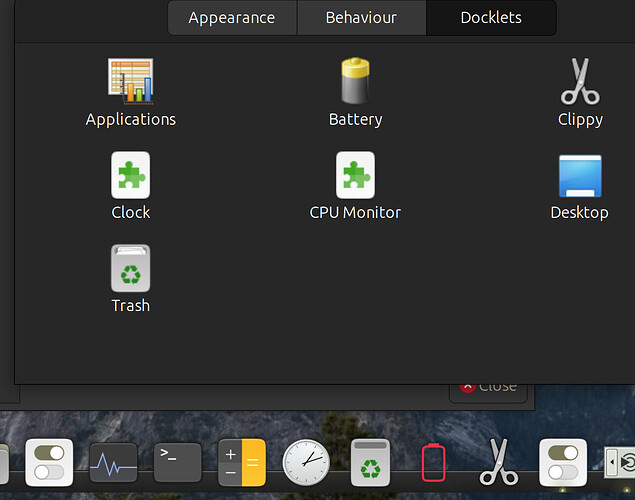

  1. For the dock, I can right click it and go into preferences. I then went to the ‘Docklets’ section and added the Battery and Clippy. The battery always shows an empty battery symbol even if this is not true (despite the fact that MATE correctly knows my laptop battery in every other situation). Also, I have found no way to remove these Docklets from my Dock if I don’t want them anymore.

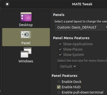

  2. In MATE Tweaks, I have tried turning on ‘Enable HUD’ but I have never been able to get the HUD to work. I’ve tried Alt L and I’ve tried changing the key combination to something else via ‘HUD Settings’ but nothing works to get it to open for me.

You should be able to enable the HUD in Mate Tweaks, by placing a check in the box next to that option, as seen below:
If you are not sure it is enabled, you can also use the command line:
sudo gsettings set org.mate.hud
Once that is done, from within any GUI-based application to which you have given “focus”, and your cursor is NOT in a text input box, you can press the “/” key, which will trigger the pop-up of a search box, into which you can enter the string you are searching for, or, you can hit the “Esc” key to exit the HUD.
Unfortunately, unlike all other icons on the dock, any docklets I added through the properties menu do not have that option. Right clicking them does nothing.

Can you click and hold the docklet and drag it towards the desktop background? That should remove them.
No joke as I tried that I was very much enjoying the poof animation it causes. Thanks for your help!
