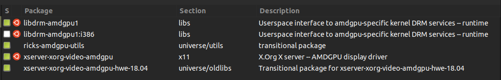

Warning about missing firmware files for "amdgpu"
The following are the installed packages related to "amdgpu", reported by Synaptic:
Does anybody have an explanation as to why I am starting to see the following error, whenever I run
