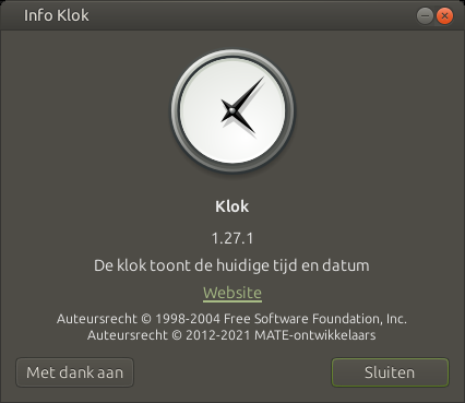

If that is the case then you should be on version 1.27.1 of the clock/weather applet, not on 1.26.1
The best option at the moment is to find out why you are still on version 1.26.1 instead of 1.27.1 because there might be something wrong with your updates and that could be way more serious than a non-functioning weather applet.
Can’t tell you man. Just upgraded 22.04 to 24.04 using apt. No idea why it’s still using 1.26.1 instead of 1.27.1. Am open to suggestions. Tkx.
