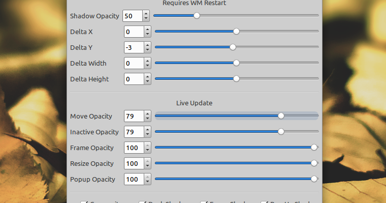

Compiz is too much.
Will be possible in the future to have something like xfce compositor for transparency?
https://wiki.ubuntuusers.de/Xfce_Composite-Effekte
Or like Xfce4 Composite Editor:
Thank you!
You can try Compton, which is pretty lightweighted. The Xfce compositor is tied to the Xfce window manager anyway, it can’t be used on it’s own. It’s like Marco on Mate.
The main drawback of Compton is that it’s not easily configurable as the settings are made in a config file and not a GUI. Not sure if Compton allows for windows transparency but according to the Achi wiki, you can try transset-df (https://wiki.archlinux.org/index.php/Per_Application_Transparency). Not sure it’s up to date, though, as the wiki page has been written for xcompmgr (the “ancestor” of Compton) and so is liquely several years old.
If you’re looking for effects like Exposé on MacOS (i.e. you press a key and all active Windows appear on screen to choose one − like a super alt-tab), which isn’t handled natively by Maco or Compton − not sure about Compiz − you can look at Skippy-XD. Not sure it’s still developed, but you can check there: http://www.webupd8.org/2013/07/skippy-xd-expose-like-window-picker-for.html
