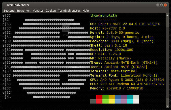

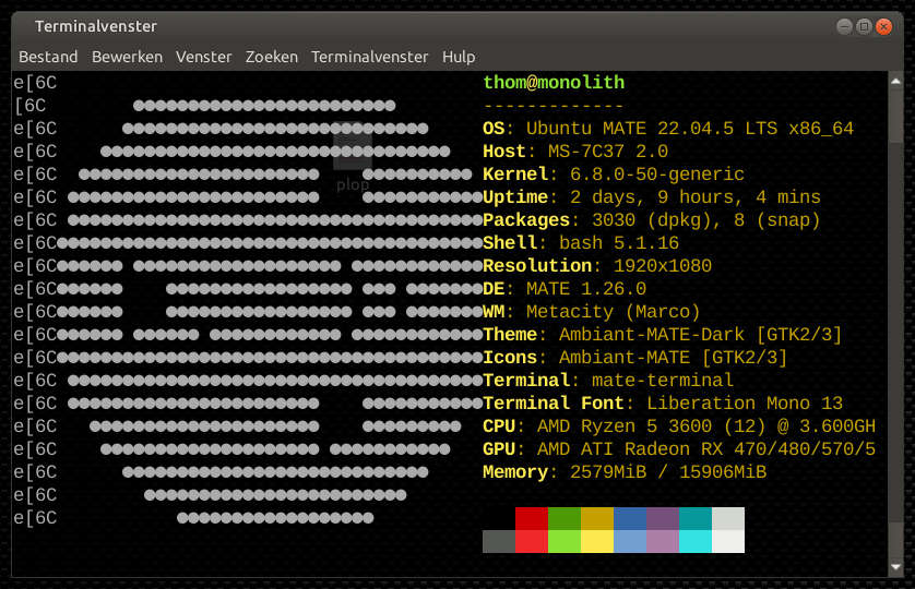

Then I am VERY interested in knowing which Font is your default for MATE Terminal. If you use a different program, which one do you use?
Yes I used Mate-terminal with Ubuntu mono regular as font.
With Liberation mono regular it looks like this:
Something seems to be off with the ANSI-escape codes.
