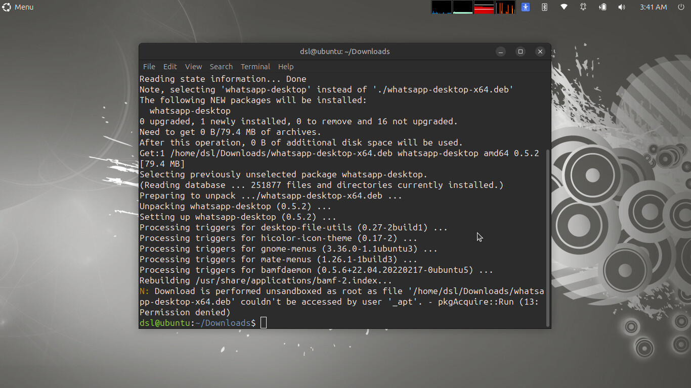

hello guys i installed Ubuntu mate i installed whatsapp desktop but i got issue while opening the app i install it by deb file
sudo apt install ./Downloads/whatsapp-desktop-x64.deb
i install it on debian it's worked
APT is for installing from repositories. What happens when you run:
dpkg -i --dry-run ./Downloads/whatsapp-desktop-x64.deb
Then try (if the output from the previous command looks reasonable):
sudo dpkg -i ./Downloads/whatsapp-desktop-x64.deb
You can also open the .deb file with GDebi, and install via its GUI.

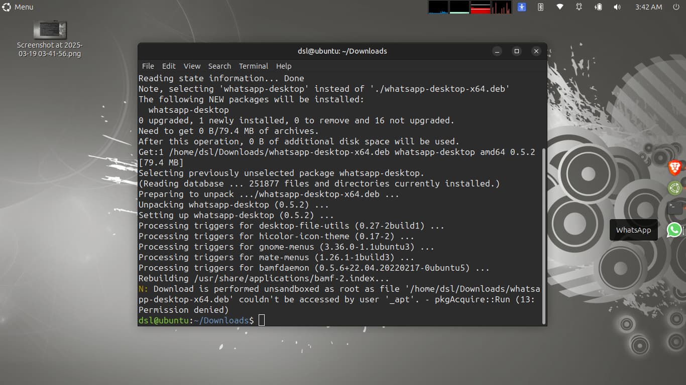

I'm not seeing an error in your screenshot. It appears to have installed but is just showing a warning "unsandboxed as root" which I get on mine.
Does the program show up in the Menu and does it run?
apt can install package files too, as long as it starts with ./ - it's better at resolving dependencies I think.

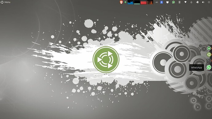

it's installed but no't opened i press on it showing the icon on the plank dock only

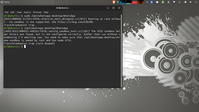

Run it from the terminal; you might get some useful error output.
i installed by
how to run it from terminal?

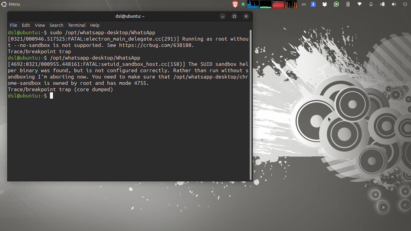

From looking at the package contents, this command runs the program:
/opt/whatsapp-desktop/WhatsApp
i got this issue the icon it's showing like this only and it's no't open
Based on the output, it would like you to run these commands to fix the permissions to what it expects:
sudo chown root /opt/whatsapp-desktop/chrome-sandbox
sudo chmod 4755 /opt/whatsapp-desktop/chrome-sandbox
Then it should run after that. :crossed_fingers:
