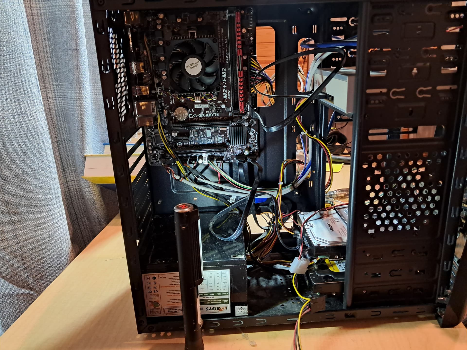

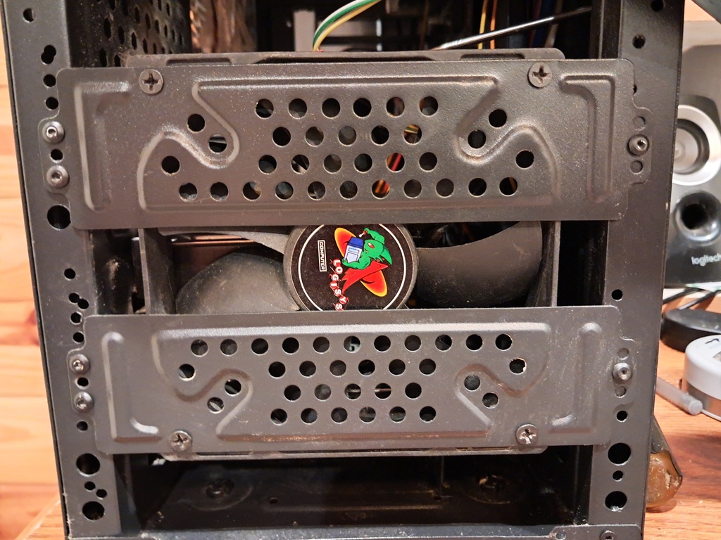

Where does lead to hard drive fan go?
I can not find where to plug the lead to the hard drive fan.
I got it all cleaned up and running like a top.
I think I had about a tablespoon of dust that came loose.

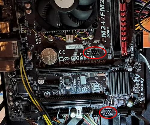

There is no dedicated harddrive-fanconnector but you can use the universal fanconnectors on the motherboard (if the connector fits ofcourse)

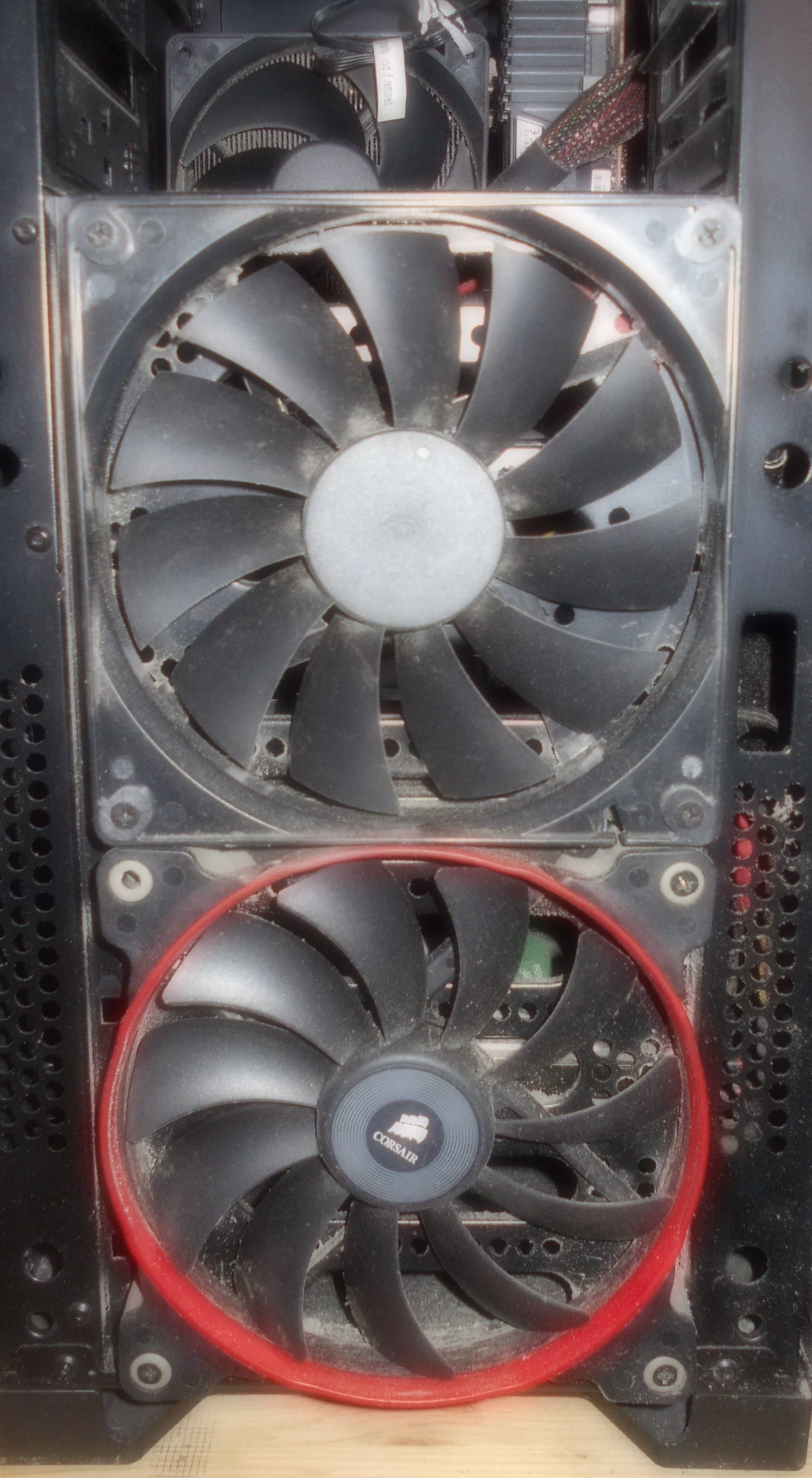

My computer has a large fan in front of my 2 hard drives.
Mine too :slight_smile:
Do you have one fan for each of your hard drives?
No, just 1 harddrive (the other is NVMe), but the fans supply half of the air intake of the case (the other two 140 mm (5.5 Inch) fans are on the side and not visible on this picture).
It might seem overkill but i set them to spin slowly (about 500 rpm) so the system is pretty quiet.

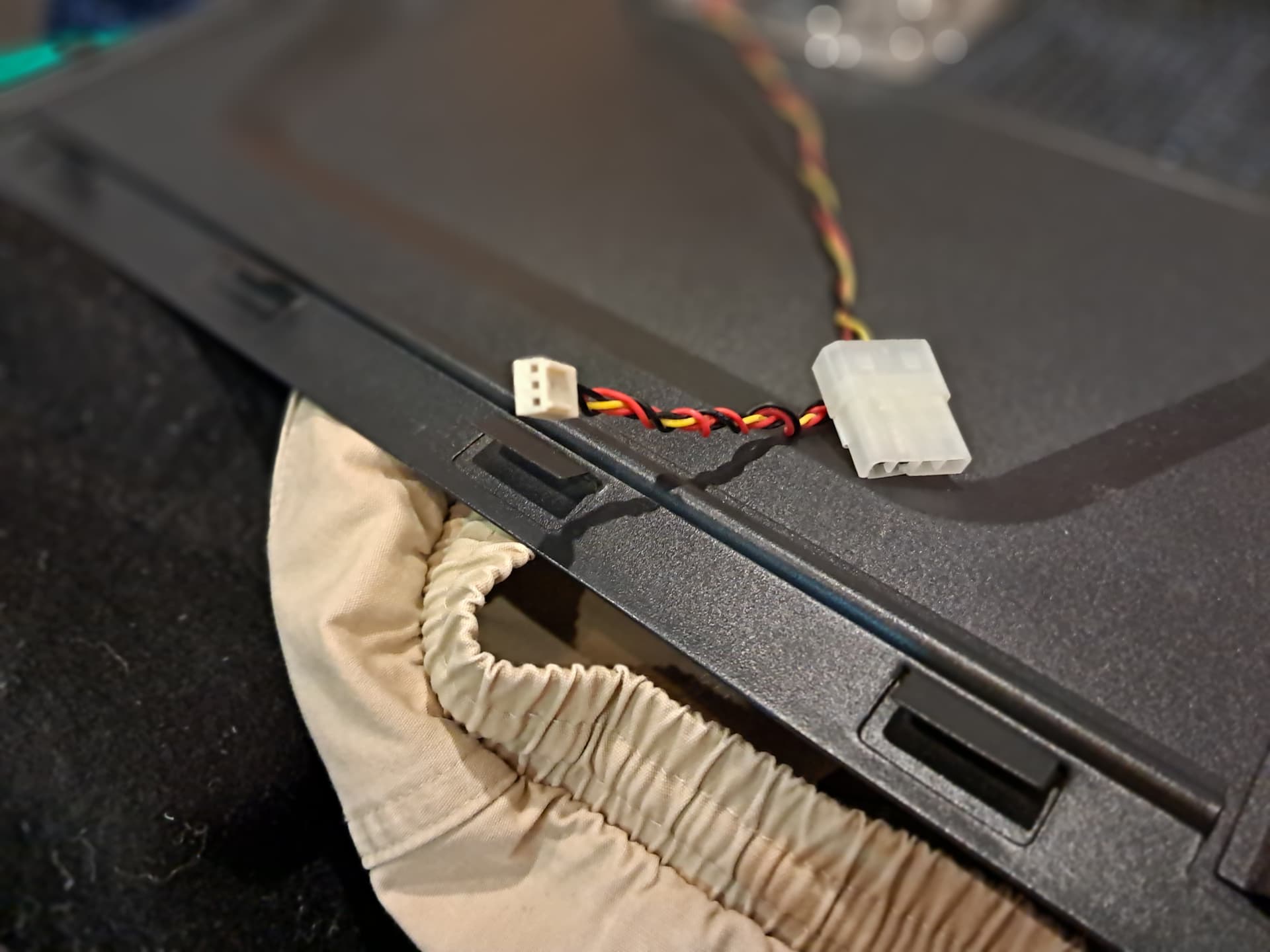

This is what I have for connectors.
The small one will fit on the sysfan1 or sysfan2 connector on the motherboard :slight_smile:
