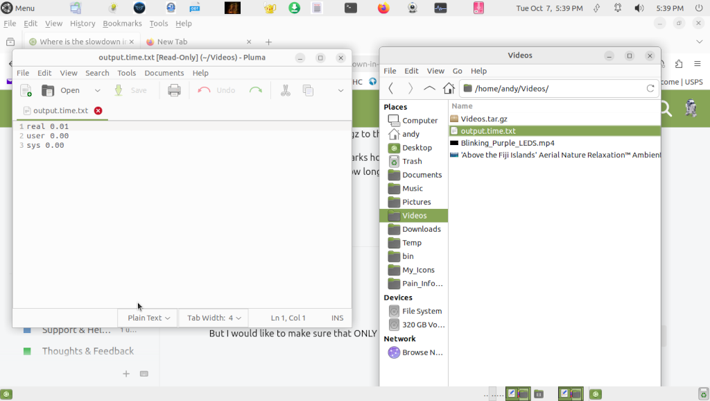

I have this so far.
cd $Videos
/usr/bin/time -p tar czf Videos.tar.gz *.mp4 2> output.time.txt
cp -a Videos.tar.gz $Maxtor_Backup_Directory
The first line tells me take all the mp4 in the Videos dir and tar/compress them. It will provide how long it took. The second line is the same idea without time. The third line will copy the videos.tar.gz to the maxtor drive.

619 Mb. for my videos.
But I would like to make sure that ONLY newer files are compressed.
Looks pretty quick.
thanks. I will try it.

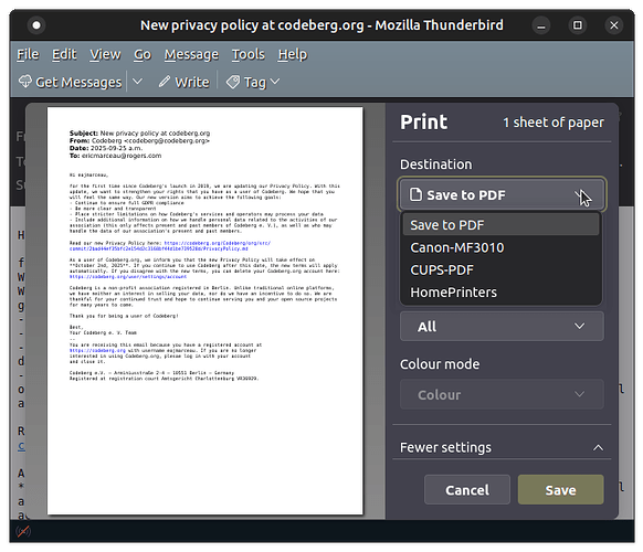

What mail application do you use ?
In Thunderbird you can use the "save as" option.
In the save dialog you can select "Text".
Thanks tkn.
I have been wanting to install Thunderbird. :slight_smile:
Is your email tool GUI based?
If so, can you double-click to open your chosen email by itself in a window?
Again, if so, you can
  • click to select Print
  • choose from Print options for "Save as PDF"
  • generate the PDF file
  • then use the following command to convert the individual pages into separate images (replace the # symbol by the Number-Of-Pages less 1, i.e. if total 5, enter 4):
You can manipulate the output resolution by adding the option
-density 300
