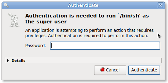

For the last week or so, when I start my computer a mysterious request appears that a /bin/sh process requests root privileges and would I please authenticate. Not even for my best friend. A little investigation found this is coming from polkit-mate authentication-agent. Have I been hacked or is this legitimate. And, in any event, can I get rid of it or un-install it? This is my first post on a forum like this. Thanks for your help.

I'll give an example on my own system. I ran a program that needed more privileges to do its thing. Polkit presented me with this message:
Well, that doesn't tell me much -- /bin/sh could be used to run just about anything! So let's open up that "Details" box at the bottom of the dialog (click on the "Details" string itself to open it):
OK, two process IDs (PIDs) are listed in the details. The more important one here is the "caller PID", which is the PID of the program that requested the privileges from Polkit. Still, let's investigate both. Open a terminal window (you can press Ctrl-Alt-T to get one), then type:
