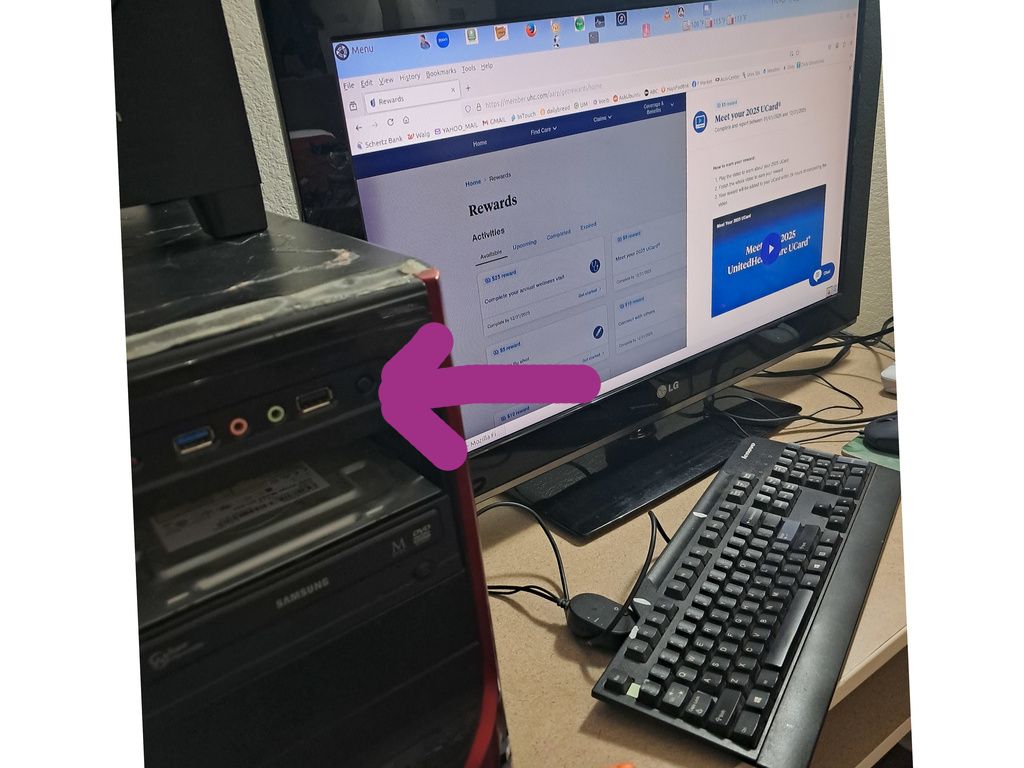

Every once "in a blue moon" my computer freezes. Ctrl Alt Del does not work and I have to use this button to reboot the computer.

No big deal as that "unknown button press" restores things.
I sure would like to know what that button does?
I can not find any diagram for it.
Outta here.
The little button on the case will be the RESET switch. It's a soft restart button, so kind of like powering it off then on again.
