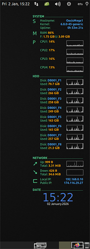

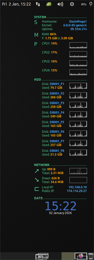

One thing you need to keep in mind is that a lot of the component "placement" is "referential", meaning relative to other components. That can be tricky, which is why it usually takes time to "tweak" it to what any individual wants. It is a grind, but it is worth it, once you're done!
My current conky configuration gives me the following look:
Forgot to add the conky config file for my running version:
conky.config = {
background = true,
update_interval = 3,
total_run_times = 0,
net_avg_samples = 1,
cpu_avg_samples = 1,
if_up_strictness = 'link',
imlib_cache_size = 0,
double_buffer = true,
no_buffers = true,
format_human_readable,
use_xft = true,
xftfont = 'Ubuntu:size=8',
font1 = 'Ubuntu:size=8',
font2 = 'Ubuntu:bold:size=8',
font3 = 'Poky:size=13',
font4 = 'Arial Black:size=28',
font5 = 'Ubuntu:size=7',
font6 = 'Webdings:size=17',
font7 = 'Webdings:size=16',
font8 = 'Wingdings:size=20',
font9 = 'Poky:bold:size=13',
override_utf8_locale = true,
text_buffer_size = 2048,
own_window = true,
own_window_type = 'desktop',
own_window_argb_visual = true,
own_window_transparent = true,
own_window_hints = 'undecorated,below,sticky,skip_taskbar,skip_pager',
alignment = 'top_right',
gap_x = 25,
gap_y = 40,
minimum_size = "200 600",
maximum_width = 200,
default_bar_size = "60 8",
draw_shades = false,
default_color = '4FCF8F',
color0 = 'white',
color1 = 'orange',
color2 = 'yellow',
color3 = '3F6FCF',
color4 = '3F9FEF',
color7 = '8F8F8F',
color8 = 'BFBF6F',
color9 = 'AF8FBF',
conky.text = [[
# - SYSTEM - #
${font2}SYSTEM $stippled_hr${font1}
${voffset 0}${offset 0}${color}${font3}S
${goto 32}${voffset -27}${font1}${color}Hostname: ${alignr}${font2}${color4}${nodename}
${goto 32}${font1}${color}Kernel: ${alignr}${font2}${color4}${kernel}
${goto 32}${font1}${color}Uptime: ${alignr}${font2}${color4}${uptime}
# |--MEM
${voffset 3}${offset 0}${color}${font3}M
${goto 32}${voffset -27}${font1}${color}RAM: ${font2}${color1}$memperc%
${goto 32}${voffset 1}${offset 0}${font1}${color}F: ${font2}${color1}${memeasyfree}${color}${font1} U: ${font2}${color1}${mem}
# |--CPU	#${goto 32}CPU1: ${font2}${color1}${cpu cpu1}%${color}${font1} ${alignr}${color0}${cpugraph cpu1 20,60 77507B 5C3566}${color}
${voffset 3}${offset 0}${color}${font3}P
${goto 32}${voffset -27}${offset 0}${font1}${color}CPU1: ${font2}${color1}${cpu cpu1}%${color} ${voffset -2}${alignr}${color7}${cpugraph cpu1 20,60 ${color8} ${color9}}
${goto 32}${font1}${color}CPU2: ${font2}${color1}${cpu cpu2}%${color} ${voffset -2}${alignr}${color7}${cpugraph cpu2 20,60 ${color8} 5C3566}
${goto 32}${font1}${color}CPU3: ${font2}${color1}${cpu cpu3}%${color} ${voffset -2}${alignr}${color7}${cpugraph cpu3 20,60 ${color8} 5C3566}
${goto 32}${font1}${color}CPU4: ${font2}${color1}${cpu cpu4}%${color} ${voffset -2}${alignr}${color7}${cpugraph cpu4 20,60 ${color8} 5C3566}
# - HD - #
${voffset -12}${color}${font2}HDD $stippled_hr
${offset 27}${voffset 2}${font1}${color}Disk: ${font2}${color4}DB001_F1
${offset 27}${font1}${color}Used: ${font2}${color1}${fs_used /}
${voffset -28}${font1}${offset 122}${color7}${diskiograph 20,60 ${color8} ${color9}}
${offset 27}${voffset 2}${font1}${color}Disk: ${font2}${color4}DB001_F2
${offset 27}${font1}${color}Used: ${font2}${color1}${fs_used /DB001_F2}
${offset 27}${voffset 2}${font1}${color}Disk: ${font2}${color4}DB001_F3
${offset 27}${font1}${color}Used: ${font2}${color1}${fs_used /DB001_F3}
${offset 27}${voffset 2}${font1}${color}Disk: ${font2}${color4}DB001_F4
${offset 27}${font1}${color}Used: ${font2}${color1}${fs_used /DB001_F4}
${offset 27}${voffset 2}${font1}${color}Disk: ${font2}${color4}DB001_F5
${offset 27}${font1}${color}Used: ${font2}${color1}${fs_used /DB001_F5}
${offset 27}${voffset 2}${font1}${color}Disk: ${font2}${color4}DB001_F6
${offset 27}${font1}${color}Used: ${font2}${color1}${fs_used /DB001_F6}
${offset 27}${voffset 2}${font1}${color}Disk: ${font2}${color4}DB001_F7
${offset 27}${font1}${color}Used: ${font2}${color1}${fs_used /DB001_F7}
${offset 27}${voffset 2}${font1}${color}Disk: ${font2}${color4}DB001_F8
${offset 27}${font1}${color}Used: ${font2}${color1}${fs_used /DB001_F8}
# - NETWORK - #
${voffset -8}${color}${font2}NETWORK $stippled_hr${font1}
# |--ETH0
${if_up enp2s0}\
${voffset -1}${color}${font6}➚${font1}${color}
${goto 32}${voffset -22}Up: ${font2}${color1}${upspeed enp2s0}${color}
${goto 32}${font1}Total: ${font2}${color1}${totalup enp2s0}${color}
${voffset -28}${font1} ${alignr}${color7}${upspeedgraph enp2s0 20,60 ${color8} ${color9}}${color}
${voffset -3}${color}${font6}➘${font1}${color}
${goto 32}${voffset -22}Down: ${font2}${color1}${downspeed enp2s0}${color}
${goto 32}${font1}Total: ${font2}${color1}${totaldown enp2s0}${color}
${voffset -28}${font1} ${alignr}${color7}${downspeedgraph eth0 20,60 ${color8} ${color9}}${color}
${voffset -3}${color}${font6}⊏${font1}${color}
${goto 32}${voffset -22}Local IP: ${alignr}${font2}${color4}${addr enp2s0}${color}
${goto 32}${font1}Public IP: ${alignr}${font2}${color4}${exec ~/.config/conky/conkyIp}${color}
${endif}
# - CLOCK - #
${voffset -14}${font2}DATE $stippled_hr${font1}
${voffset -3}${alignc}${color3}${font Arial Black:size=30}${time %H:%M}${font1}
${alignc}${color0}${time %d %B %Y}${font1}
## |--WLAN0
#${else}${if_up WLAN0}
#${voffset -5}${color0}${font6}”${font1}${color}${goto 32}${voffset -5}Up: ${font2}${color1}${upspeed WLAN0}${color}${font1} ${alignr}${color2}${upspeedgraph WLAN0 8,60 77507B 5C3566}${color}
#${goto 32}Total: ${font2}${color2}${totalup WLAN0}${color}${font1}
#${voffset 2}${color0}${font6}“${font1}${color}${goto 32}${voffset -5}Down: ${font2}${color1}${downspeed WLAN0}${color}${font1} ${alignr}${color2}${downspeedgraph WLAN0 8,60 77507B 5C3566}${color}
#${goto 32}Total: ${font2}${color2}${totaldown WLAN0}${color}${font1}
#${voffset 2}${color0}${font3}Y${font1}${color}${goto 32}${voffset -2}Signal: ${font2}${color1}${wireless_link_qual_perc WLAN0}%${color}${font1} ${alignr}${color2}${wireless_link_bar 8,60 WLAN0}${color}
