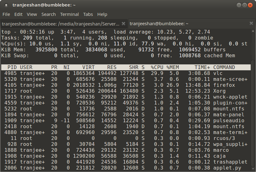

Have you tried running top or htop during a transfer to see if an errant processes as consuming too much mermory or disk I/O?
No, I didn’t. But I would try and let you know as it happens.
I’ve seen your bug report in Launchpad but I can’t reproduce what you describe :frowning:
I set the environment to reproduce the issue. I started copying some folders totalling 11GB to an USB device, started unzipping two large zipped files totalling 8.9GB, played 1080p movie totalling 4.5GB, opened few other folders, two screenshots, etc. Everything was working fine initially, but with the passage of time, my Laptop started to become unresponsive. At one time, movie on VLC was stopping frequently, applications wasn't responding, or responding after a long while, Main Menu was responding after a while, etc. I started top in terminal beforehand and attached the screenshot herewith. I'm not sure whether it would be of any use. But I can reproduce this issue again, I'm confident about that. :disappointed:

Yeah, I don’t really know what to say about that man. Your CPU is fairly beefy, so no worries there.
I will say you are putting a tremendous load on that hard drive, with unpacking two files (reading and writing from your drive), playing by a HD movie (reading) and trying to transfer data (reading).
That drive is likely only giving you about 40 - 50% of it’s stated transfer speeds as well.
http://hdd.userbenchmark.com/SpeedTest/434/ST750LM022-HN-M750MBB
I have no idea why you aren’t seeing similar issues on another other desktop or distribution though.
I'm scratching my head too. The only real weak link in your hardware chain is your HDD. I've had 5400 RPM drives in laptops too disk I/O is really terrible on them. Coupled with a fairly limited amount of RAM (so you end up relying on swap) and the system is brought to its knees.
But I don't see this issue with other DEs; especially the lighter ones, like Xfce, LXDE, etc.
And I don't usually put that much pressure. I started these jobs at the same time to make sure I woule be able to reproduce the issue. Usually only transferring large files/folders to/from USB device would make the system unresponsive. And also while unzipping large files. Otherwise, everything works just fine.
What happens if you try another file manager to transfer the files? Thunar or PCManFM for example. SpaceFM is another good one.
I used both Thunar and PCManFM in these use-cases, but neither of them in MATE. So I guess, I'll try. I'll let you know.
I installed both Thunar and PCManFM, and found the same problem under MATE. Seems like I'm having this problem with MATE. I tried Xubuntu and couldn't reproduce the issue. I may have to abandon UM for now. Maybe I'll try it again when 15.04 comes out. Any other thoughts on how to solve the prob?
Sorry man, the only thing you can really do is process of elimination. If it’s not the file manager then try transferring files without the video playing or without extracting files. Try different combinations until you notice a difference. Another thing you can do is try a different archiver to extract the files. Also what happens if you extract and move files using the command line?
I usually extract these files using terminal. So that's not a Caja and/or Engrampa specific problem. And I tried copying files/folders using the terminal. The same issue happened. So I guess it's MATE specific. :frowning:
Sorry. Apparently I was wrong all along. This problem is not any DE specific. I was able to reproduce this in different DEs: MATE, Unity, Xfce, LXDE, etc. I guess the problem lies with my hard disk drive’s low RPM and thus putting lots of pressure on it.
Can you invalidate the bug at Launchpad.net too please? :smiley:
Oops! Forgot that part. I just changed the status to invalid.
This is a long standing issue and it is not MATE specific.
It is kernel specific… Process scheduler specific to be more precise.
One could change the default scheduler, as there are different implementations with different goals, however AFAIK non of the FLOSSy ones does not cover DE responsiveness as a main target.
“But, wait, there is no excess CPU usage in the top’s report!” one might say.
Well… Yes and no… There is no excess usage as CPU will do more, but it can’t. There is no data - hdd’s seeking is stalling the whole system… Try running nmon and look how IOWAIT spikes trough the roof (as nmon kindly also visualize IOWAIT along the user and system CPU time).
Network is also accounted in and may add additional IOWAIT time.
I’ve long noticed that heavy disc usage can stall the entire system, and seen folks try different schedulers with different degrees of success. It’s interesting stuff.
Even though it’s a bigger issue on the desktop, it’s an issue in other areas as well, and heavy disk utilization tasks are an area where BSD offers better performance than Linux, from what I’ve read over the years.
